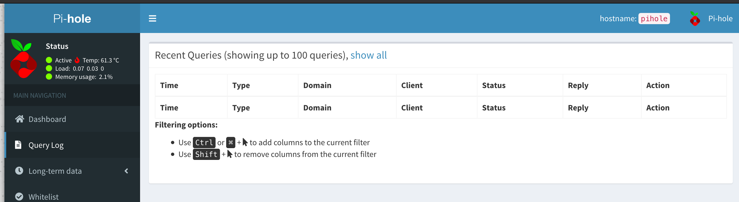

Query log is empty (but tail pihole.log works fine)
The issue I am facing:
The query log page shows nothing (not even "no logs" as I see on other screenshots here), but pihole works fine and logs are actually recorded (/var/log/pihole.log)
Details about my system:
Raspberry Pi 4B. Fresh install of pihole.
DHCP server is also running fine.
Privacy level = 0
Nothing, it never showed up.
I actually had to reinstall pihole this same day for other reasons, and in the previous install (same config/hardware), logs were showing fine, but not anymore on this fresh install.
I checked privacy level and other hints from topics I've found on the subject, but nothing seems to work:

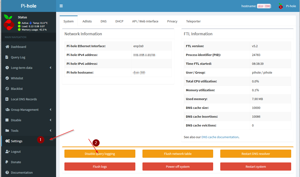

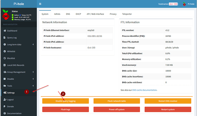

@bastien, What happens when you "Enable Query Logging" or disable and re-enable?
Hey jabbadahat, thanks for the feedback.
Tried and nothing happens. Also tried to disable + flush + enable, but no luck
