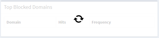

Query Log empty
Happens to me too. Console shows no errors.

the console showed no errors while the spinner was shown.
This URL only shows me:
{"top_queries":,"top_ads":}
You have to be logged in on your dashboard in the same browser.
I was logged in.

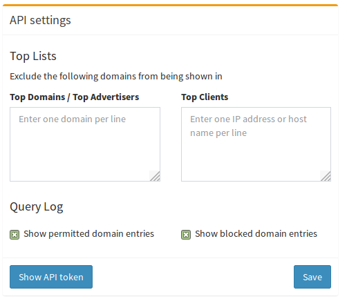

API_EXCLUDE_CLIENTS=192.168.1.115
API_QUERY_LOG_SHOW=nothing

There we go ... please remove this line.
seems to work fine again thank you for your fast help :slight_smile:
Would be interessting to know why this was suddenly in my config.
I don't know ... we used to have a setting for this on the Settings page but it was accidentally be removed. I guess it could have been triggered by the lack of these settings.
It's already back on the FTLDNS web branch:
