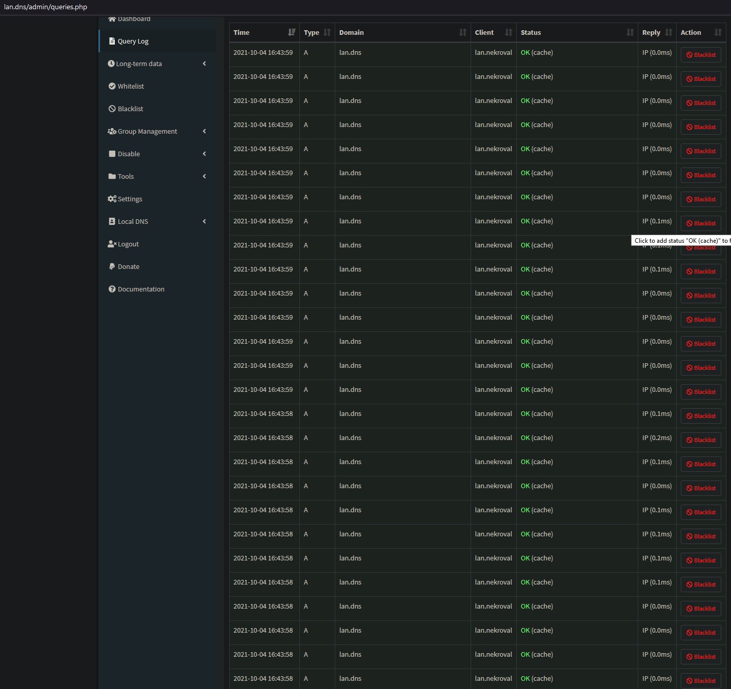

Query Log 99% of PiHole HostName from Router
Expected Behavior:
Log should only show ALLOWED / DENIED requests.
Actual Behavior:
Most of the log is (Client = Router) looking up the PiHole Server for DNS Entry (Domain = Pi_HostName)
Notes
I noticed this when setting up a preprod network to test before switching out all my networking gear. I think it is due tot he fact I'm not using the standard "192.168.X.X" setup and using a custom SUBNET. Is there a way to filter this? I saw some stuff on rfc6761.conf but can't find custom setups via the Googles to set up the filter by IP Address (or hostnames).
Any help is appreciated and thank you in advance!
I'm not sure if its helping. The Type for the Local hosts is 'A'. I've tried `ANALYZE_ONLY_A_AND_AAAA' in both true and false and still get rekt on the logs. I have a screenshot here.
As your lan.nekroval is sending a legit query for lan.dns that is answered with an IP in return, you'd have to find out why your lan.nekroval client is making those requests and then look for ways to control that client's behaviour.
That's the router... PiHole is not the DHCP server so it only shows router accessing it (which is fine). The entry LAN.DNS is the Raspberry Pi (PiHole).
lan.dns: PiHole DNS Server
lan.nekroval: Router (all requests for DNS are routed to PiHole)
Note: Again, this happens when I don't use the standard 192.168.x.x as the IP Range on the Network.
Note: There's so many because we have 50+ devices on that router alone.

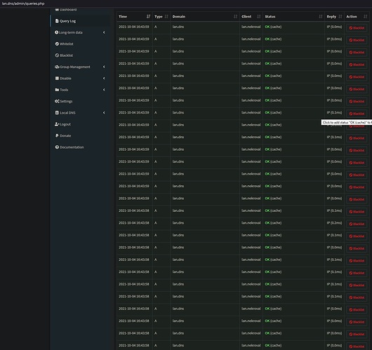

Actually, its the piHole admin site causing it... so #VISIBLE_CONFUSION.
If I use the IP for the Pi to access the admin page... no entries at all.
If I use the host defined in lan.conf (custom file). it spams the hell out of it while the page is open.
Thoughts?
