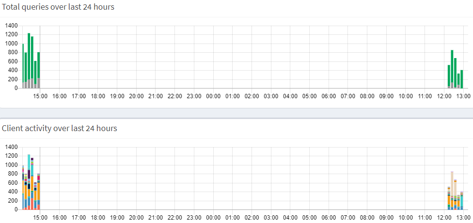

Query Database seems to be missing lots of data. This data was available earlier today, but seems to have been cleared. This has led to Total Queries and Client Activity graphs displaying large gaps. When I now look at the figures, the number of queries appears to be reducing, not increasing.
https://tricorder.pi-hole.net/F3wG4KdF/
This was a screenshot just after 13:00 this afternoon.
This is a screenshot I've taken now at 14:23.
Something is seriously not right at the moment!

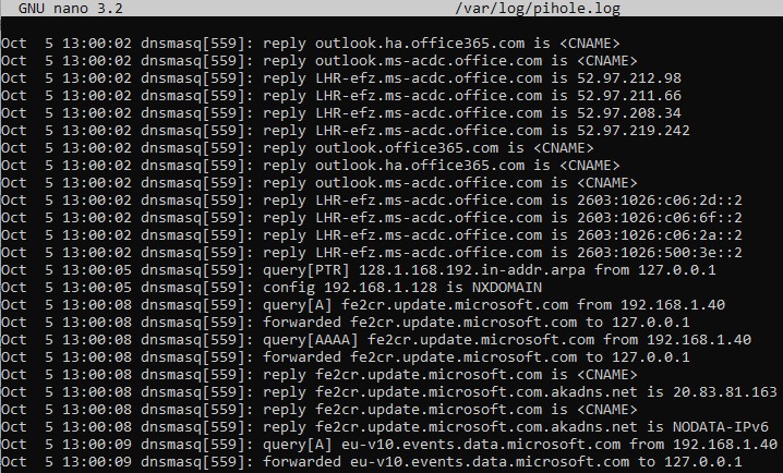

The screen shots don't necessarily indicate a problem with the database. It could be that your Pi-hole was offline for that period of time. As Pi-hole runs, the query log is populated from memory and written to the query database.
You can confirm this by looking in the dnsmasq logs for today and yesterday and see if there is any activity recorded in that log during the period in question.
Today's log is at /var/log/pihole.log
Yesterday's log is at /var/log/pihole.log.1

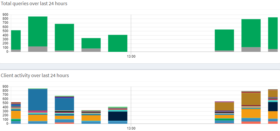

This is not unexpected, since the totals shown in the dashboard are for the most recent 24 hours. As the period of high activity on the left slides off the graph and is replaced with a lower activity period entering from the right, the numbers will decrease.

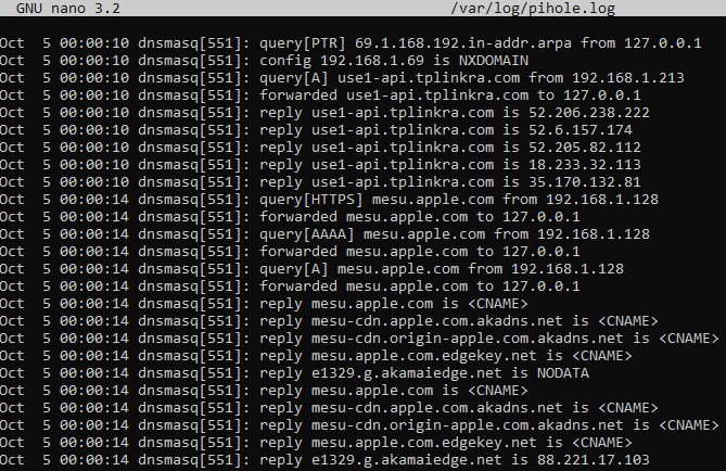

So, I've checked the dnsmasq log for today...
Both of those times are showing as empty on the graphs :confused:
