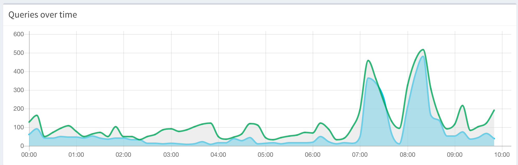

My graph is inaccurate. We're sometimes seeing 229% of requests blocked. I know that PiHole is awesome and advertising on the internet is bad, but 229% efficiency seems a smidge high. I've already done -f and -r. Just putting this out there in case anyone else has seen the same.

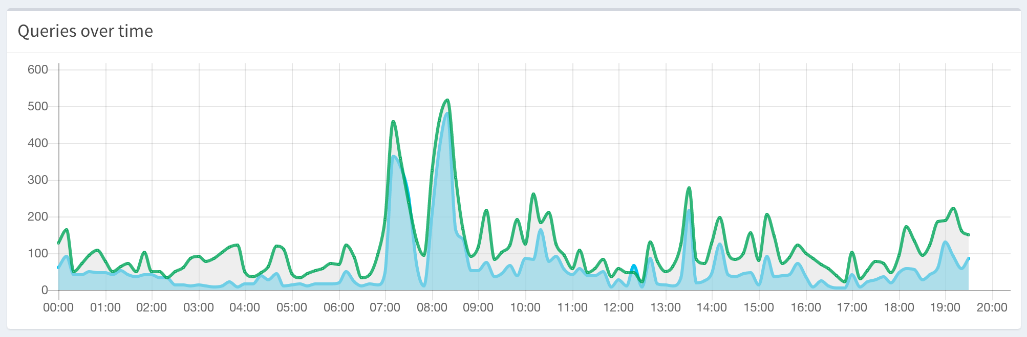

Sure thing. I'll keep an eye on it and dig in after work today. Attached image of this morning's view below.

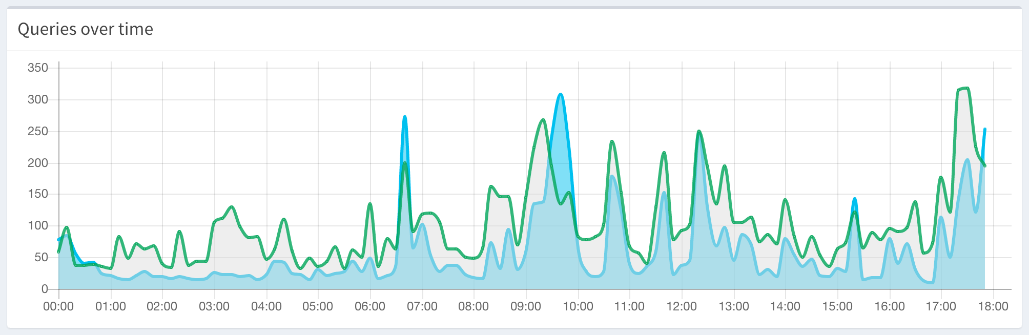

I had a look at your data and was able to identify what is going on...
In my rewrite of the algorithms I got confused by the variable names which have already been present:
return [$byTimeDomains,$byTimeAds];
Hence, I programmed it such that byTimeAds = #blocked and byTimeDomains = #total - #blocked. However, the graph expects byTimeDomains = #total. That explains why the blue line can be above the green line (it will always be if more than 50% of all requests is blocked - the shown percentage is wrong due to the very same problem).
