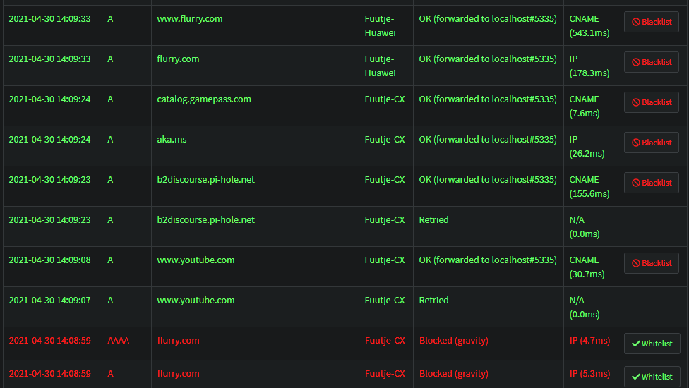

Blacklisted queries like "flurry.com" are blocked if they are requested from my computer/laptop, but not blocked when coming from connected mobile devices.
So basically, queries are handled differently depending on the device being used.

  • Huaweii P20 Pro (the device's queries show up in pi.hole/admin, but are not blocked)

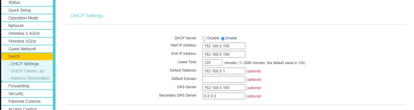

  • Put both DNS fields to point to raspberry.
  • Setting it to router does not redirect traffic to pihole for some reason

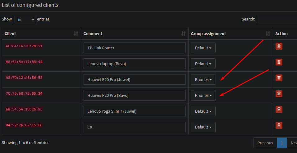

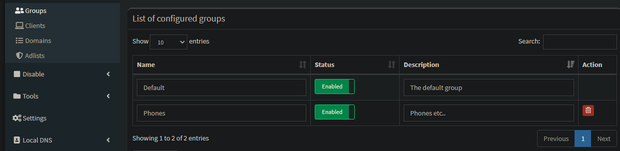

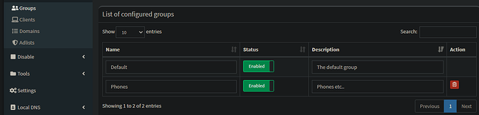

You have two phones assigned to management group 1 (phones), but you have no blocking assigned to that group.
I quickly looked at the groups and clients section in pi.hole/admin:
Since the default already has blocking enabled, I simply switched the two devices to "default"(previousely assigned "Phones"), and now everything works like a charm.
