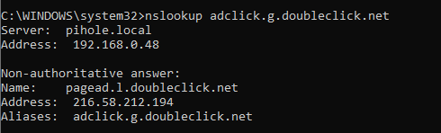

Also, when running an nslookup on something that I know is on blacklist (adclick.g.doubleclick.net in the screengrab below) it seems to resolve still, with 'non-authoritative answer' (I don't know whether that's correct or not)
