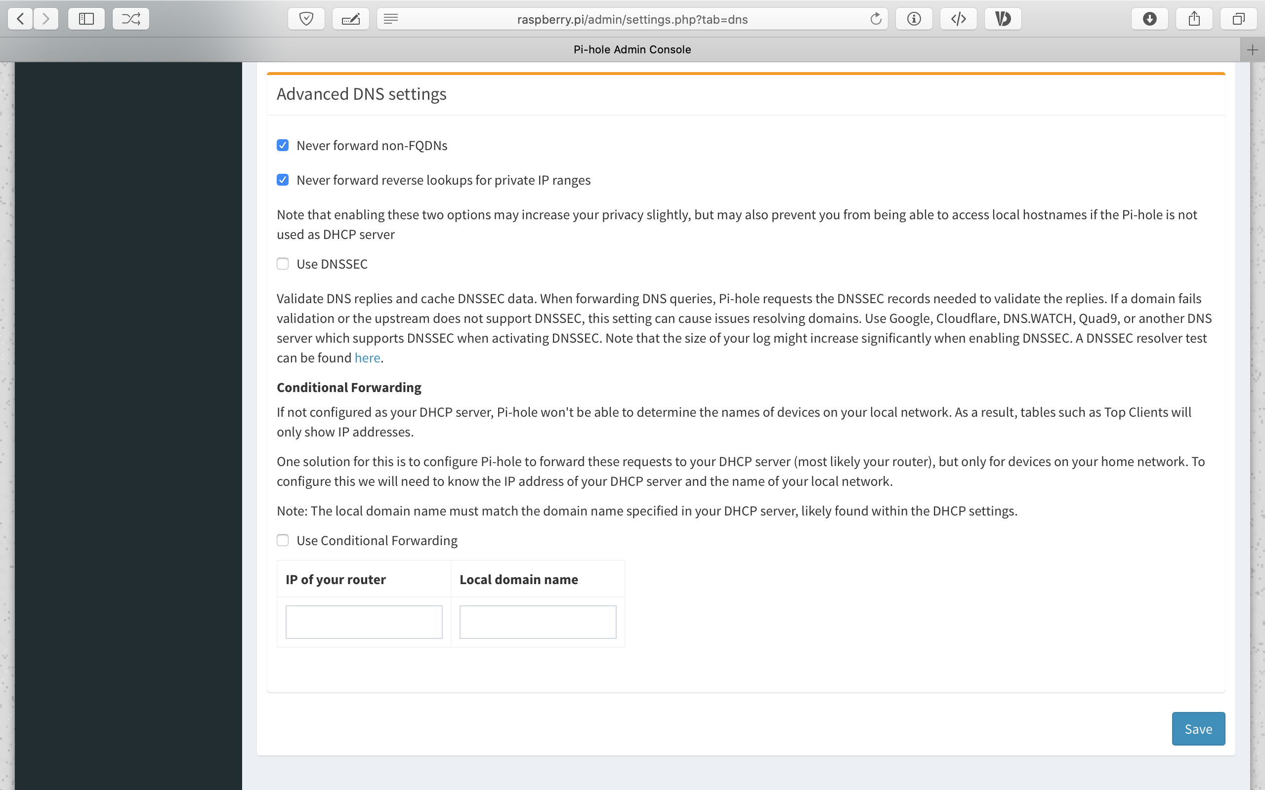

Yes, the checkbox is clear:
Hmm, @webdevelopers, does the page display the DNSSEC status irregardless of the tickbox?

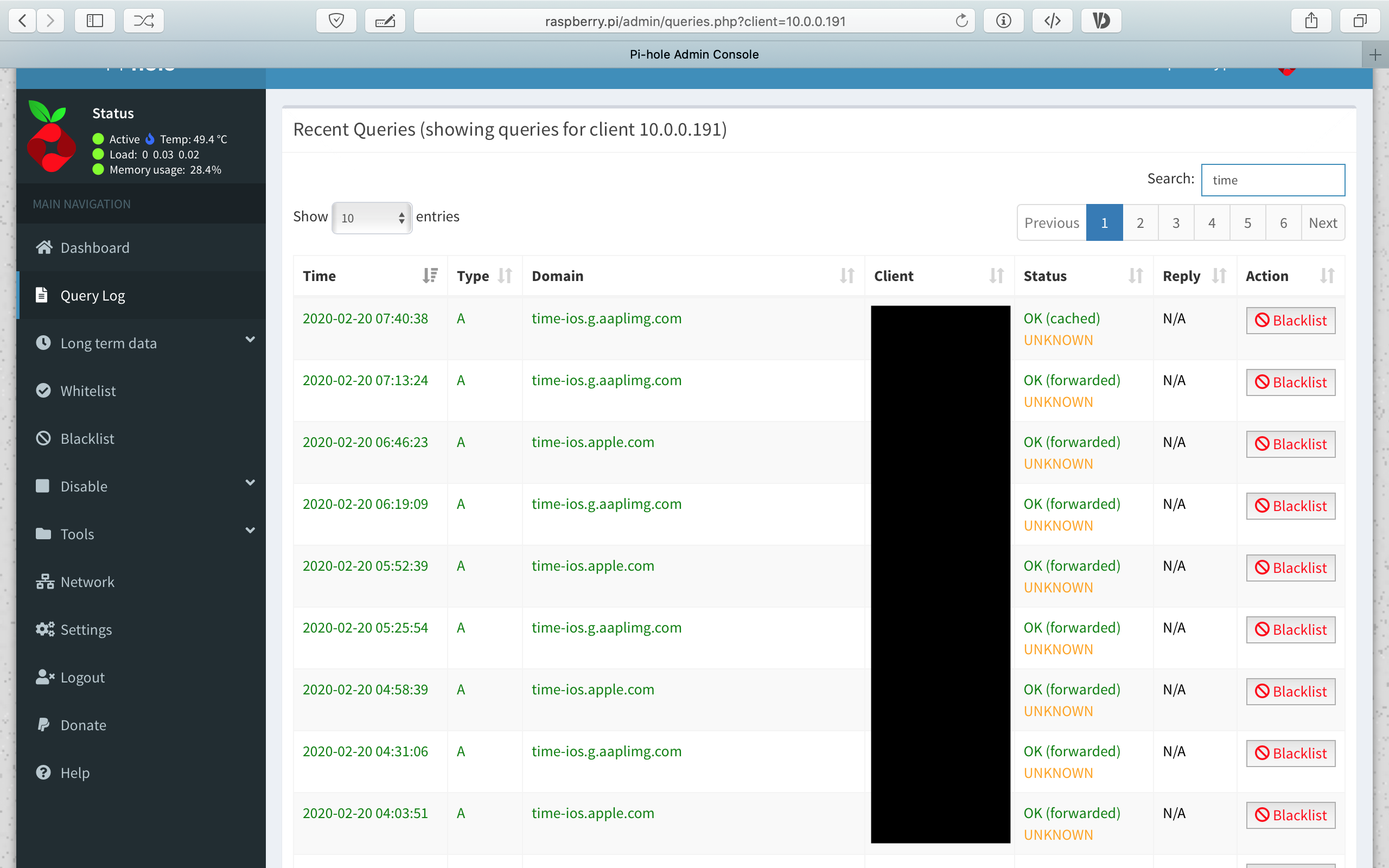

I can confirm this for my setup as well:
I do not have DNSSEC enabled, yet I do encounter entries labeled as UNKNOWN in my Query Log.
However, this seems to be true only for entries older than 24 hours.
Current entries do not show that label.
Thanks, I don't think we store the DNSSEC information in the longterm database, I vaguely remember talking about this before.
Yes, the UNKNOWN is shown for all queries imported from the database. Because the DNSSEC status is not available for them and we do not know what the status was before FTL was restarted.
