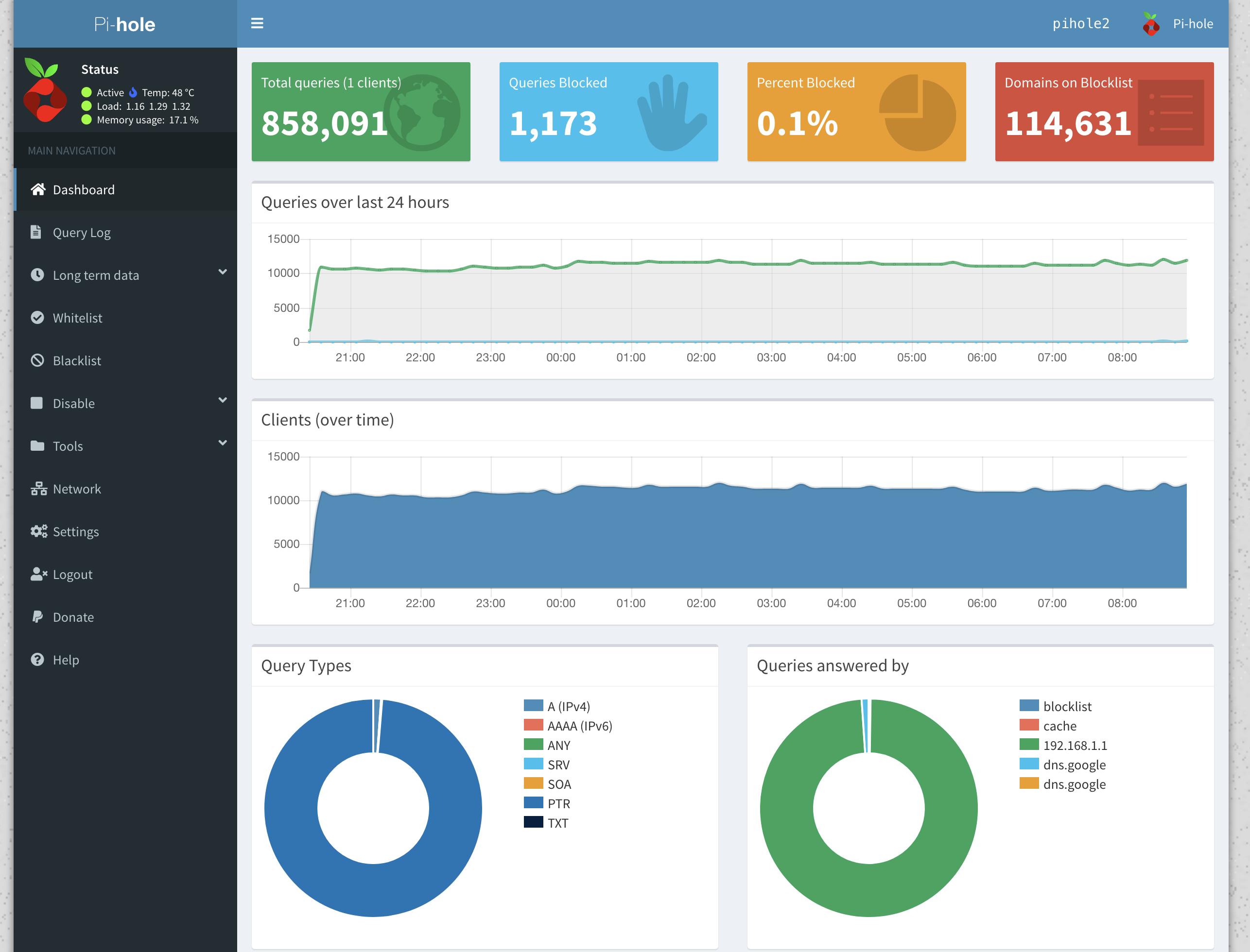

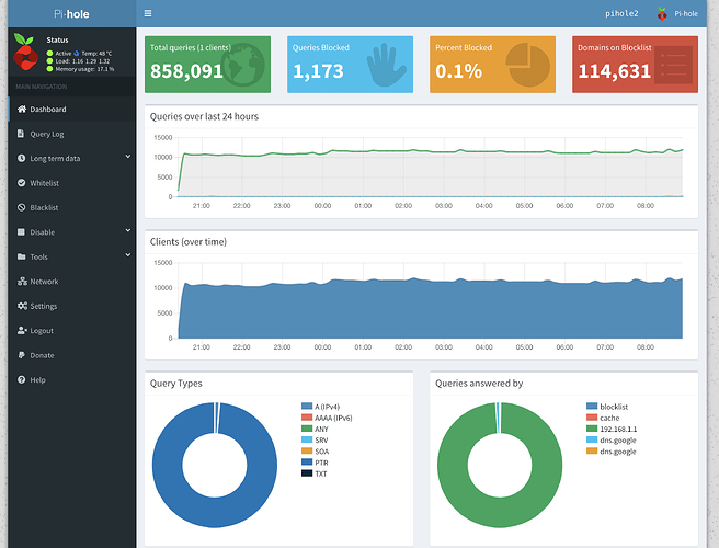

Hmm... seems like things start to become slow again... I see a very constant level of queries, even at night, where I would expect much less queries. And I don't understand the clients level... I hope I'm not running 10.000 clients somewhere I'm not aware of.
Do you recognize the IPs they're coming from? Are you sure you're not acting as an open dns relay to the internet?
edit: n/m I see you just have 1 IP address now...do you recognize the types of site being queried?
All the requests are coming from my router, which uses pi-hole as its DNS server. And the pi-hole IP is not accessible from the outside. So, I don't think it's an open relay. Is there any way to test this?
Since around 10:00 today the queries dropped down from about 12.000 in an hour to 200. I think I restarted the container... hell I'm getting old, I can't remember :wink:

I looks like you've got your router's external DNS to be the pi hole - is that by design?
The top domains are DNS Discovery Service requests. With this number of requests, you may have a loop between the router and Pi-Hole. This can be caused by conditional forwarding.
@amilroy I set the external DNS of my router manually to the pi-hole.
@jfb I enabled spanning-tree protocol on my router but seems it didn't detect it. And yes, I had "conditional forwarding" enabled and disabled it, which might have triggered the restart and the drop of the number of queries.
Response time is much better now. There are only occasionally delays and some apps on my iPhone or iPad show dome delays but looks good so far.
