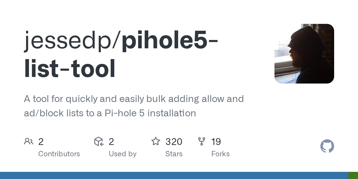

I made a little python3 tool that makes bulk adding very easy. I'm only adding this here because it was the first discussion I found when searching, so others may too. Yes it makes me feel gross and I'm sorry.
