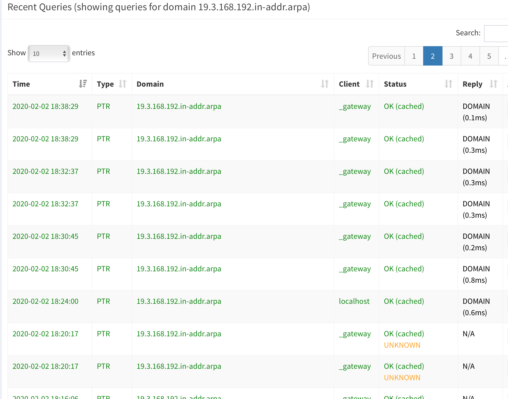

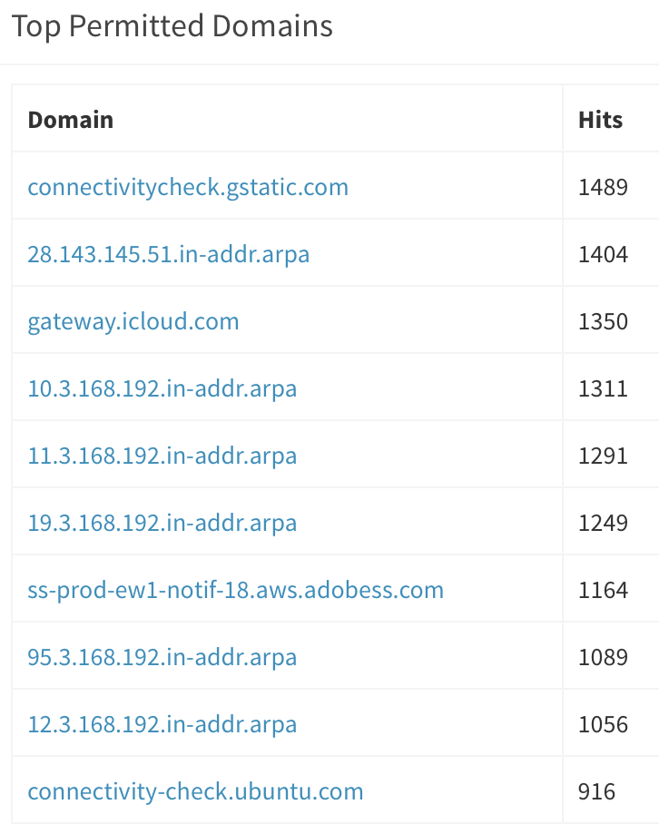

My Pihole is flooded by *.in-addr.arpa-Requests, answerd by N/A or NX-Domain.
Perhaps a bug?

Pi-hole itself is generating one PTR per client once an hour to ensure it always knows the most recent client host name for displaying.

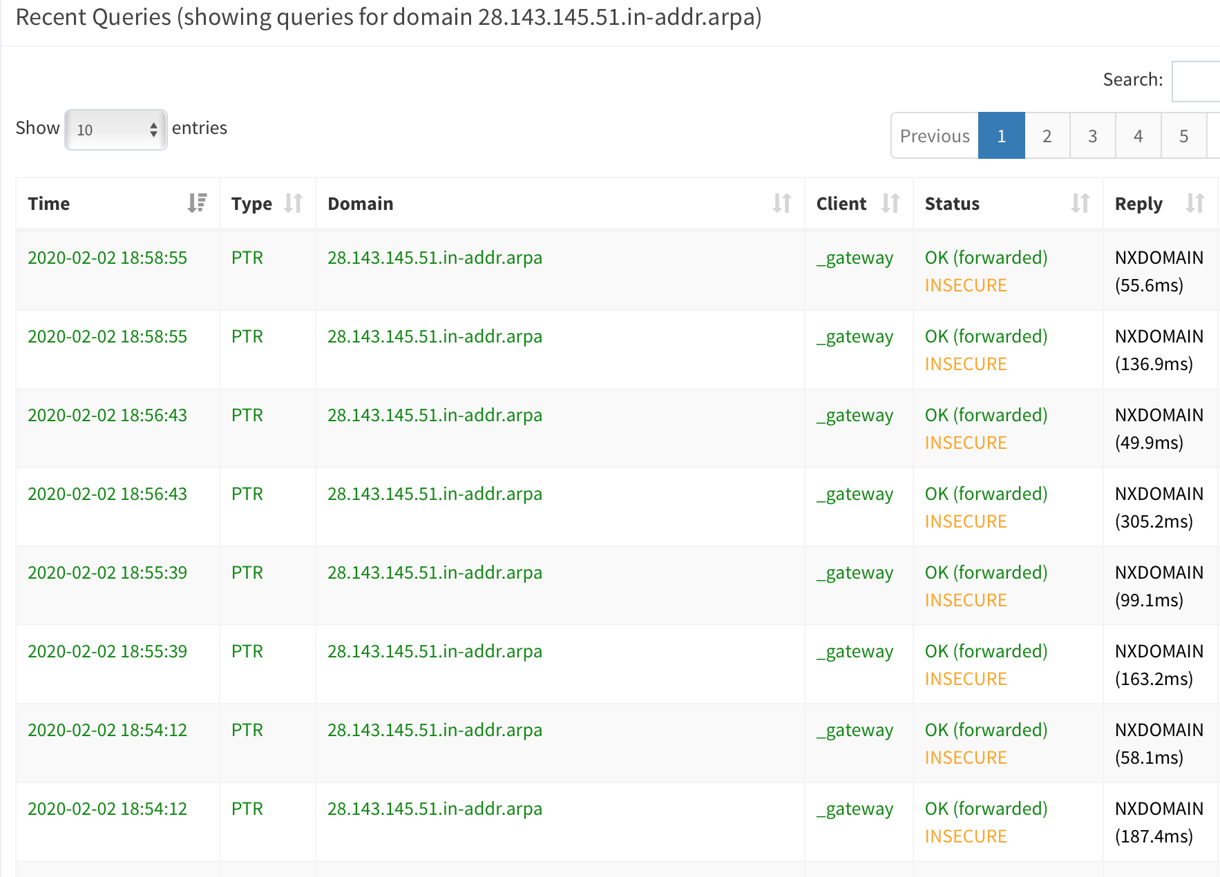

The clients ask the Gateway, the Gateway request the Pihole. Why answers Pihole with NXDOMAIN or N/A when the PTR should be correct?
Pi-hole is providing its answers as received by its upstream DNS.
A reverse lookup for 51.145.143.28 -as provided by your screenshot- does also result in NXDOMAIN on my machine.
As your gateway seems to issue those requests, try to find out why it does so.
