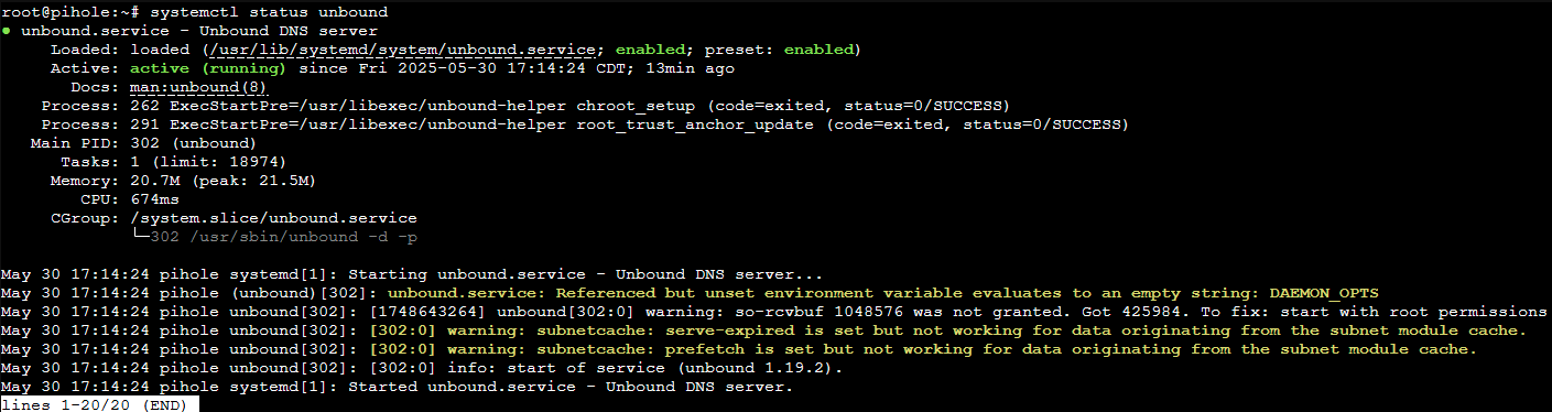

I am also getting these errors and not sure if this is normal or not..
