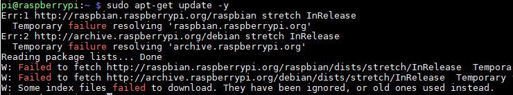

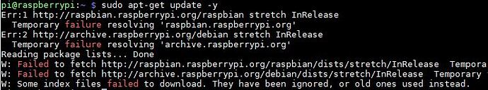

After it finished installing, I rebooted and tried to update. This isn't possible anymore:
Your Pi-hole device can't seem to get out to to Internet to get updates. Is your gateway properly set? What's in /etc/resolv.conf?
It says:
Unbenannt2
I only set 2 DNS servers during installation, that's it. I didn't mess with the gateway. I'm only confused about the setup changing my network interface or anything like that. The update / upgrade stuff worked before, why wouldn't it work anymore after the PiHole installation?

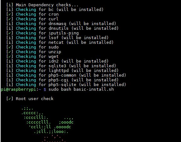

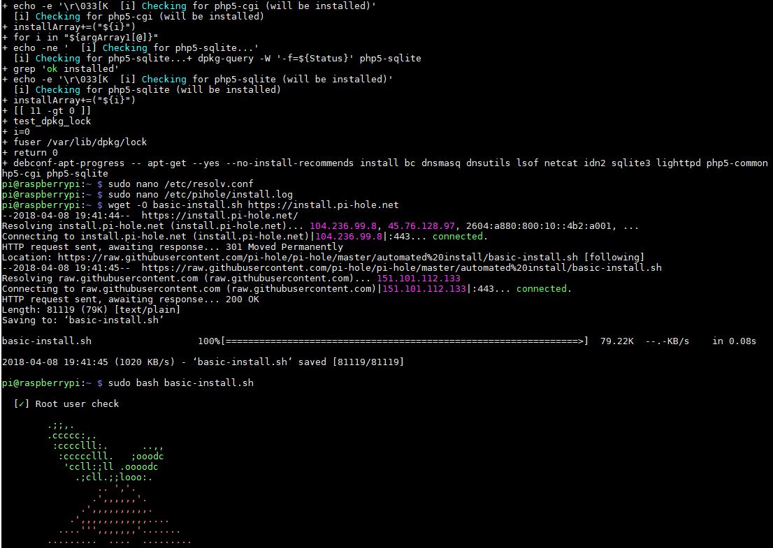

@jacob.salmela So.. somehow I made it work. I tried so many different installation variations, formatted the sd card and reflashed it countless times, and now it somehow worked. Don't ask me why it works now.
So as you can see, the installation always stopped at a random point of the script. This time it stopped before I executed "sudo nano /etc/resolve.conf":
Here, it stopped in between again:
The fix is to just execute sudo bash basic-install.sh as often as possible until the pi went through the whole script.
I don't know why it stops here and there, but it took me hours of formatting and reflashing until I realized it's only a random stop. Now, it works and I can finally access the portal.
