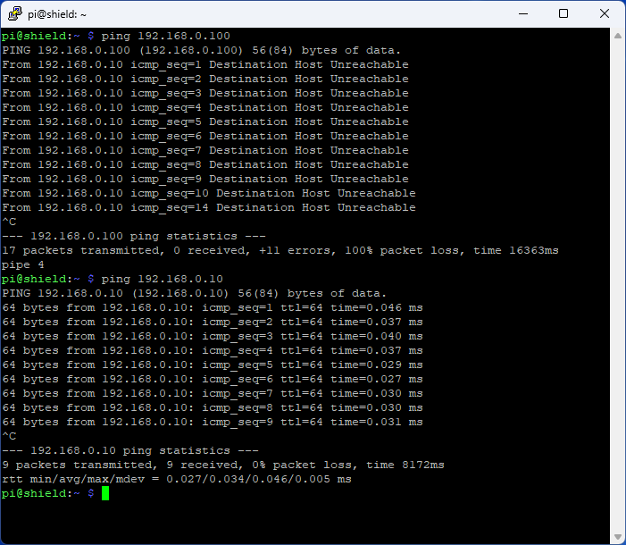

Before you try to apply that advice, I'd be curious:
Does pinging that IP produce similar output?
ping 192.168.0.100
None that I'm aware.
Hi and thanks
These are the results
Ping to OpenMediavault (192.168.0.10) --> Okay
Ping to Pi-Hole (192.168.0.100) --> don't work
