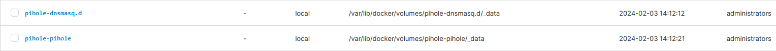

Looks like you already created 2 named volumes: pihole-dnsmasq.d and pihole-pihole, but you are not using them in your compose file.
Your current compose file is using different volumes, using paths:

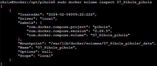

I tired this, but the result is the same.
The only difference I noticed is, that with "external: true" docker is not creating a new volume.
If "external: true" is missing, docker is creating a new volume, if this does not exist.
From my understanding "external: true" is not necessary.

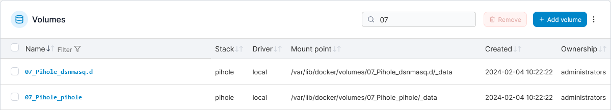

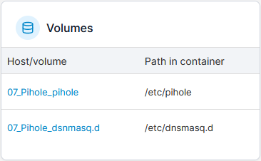

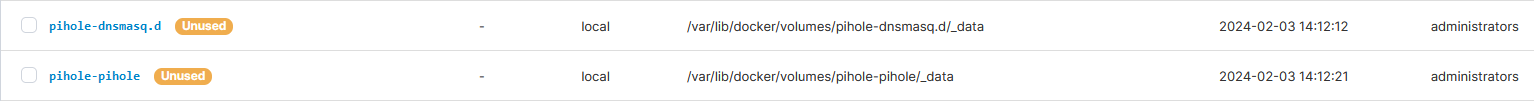

In Portainer it looks okay for me:

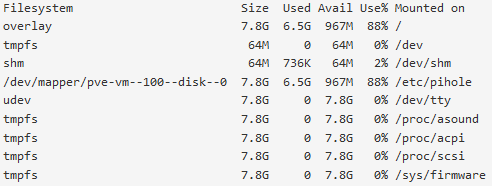

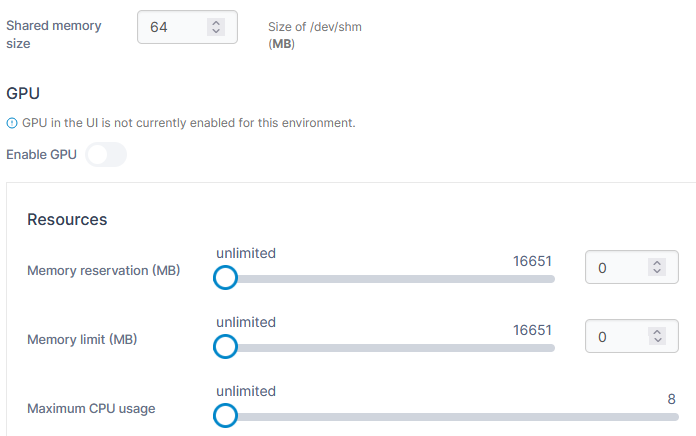

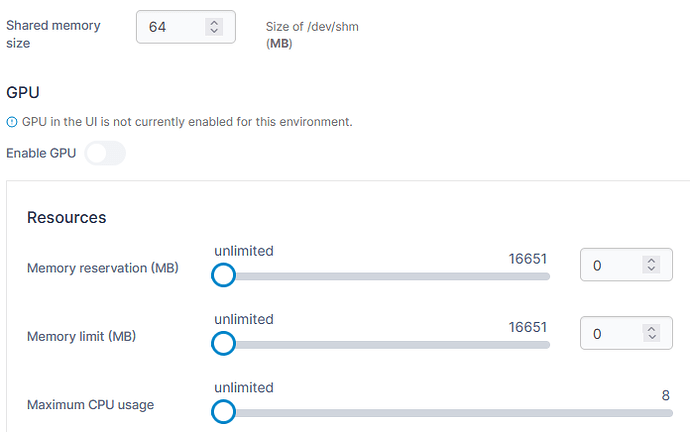

The problem is, that the disk space is too small:
But I don't know how to change it?!
This (7.8GB) is the size of the root partition on your host machine.
Thank you, now I understand and now I could solve the problem!
