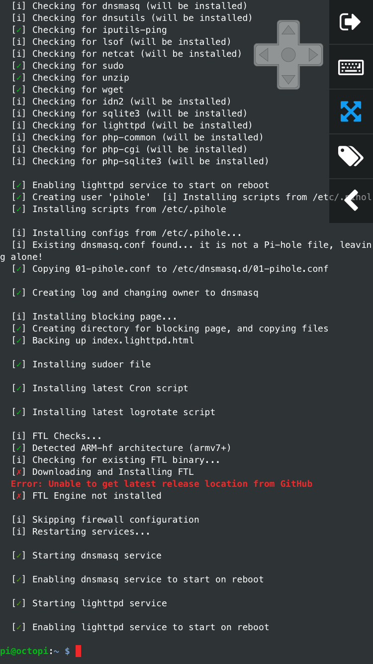

The installer runs fine and I can set up all my settings. However it does not come to the final page showing me my webportal password (and it does also not install the portal, at least i cannot open it).

If pihole is showing that command not found then indeed the installation did not finish. Can you get the output from where the install is stopping? We may need to run the install in a more verbose mode to get to the actual problem, that's why I asked you to come here as the verbose mode prints a lot of information to the terminal screen.
Hi and thanks for helping me out. I made a screenshot of the installation output. Maybe this helps. If you tell me how to get more information I’ll try this out. I could also run some commands on putty so i could copy the output text here if this is better than the screenshots from my phone.

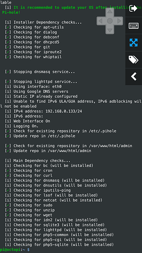

Can you install those packages successfully if you do it manually? Try
sudo apt install ...
And replace ... with the packages listed as to be installed.
I just installed the first package in the list (bc) which worked fine. Than I thought I try the install again and at the point where it normally failed a window poped up showing a percentage bar and that some things were installed. However I did not come until the final screen which should show me my login password for the web interface. I made this screenshot to show you the command line. How can I go on? Any ideas? I might need to install some more packages manually?

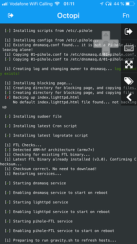

Hi. Yes it’s able to connect to the internet. But often the /etc/resolv.conf changes its entry to localhost (127.0.0.1). I don’t know why but every time I try something I need to edit it again. But I managed to get the installer run again. It asked me if I want to change settings or if I want to reinstall. I chose reinstall and got the installer to finish. However no web portal was installed. Also after a reboot it’s not there. This is what I got as an output.

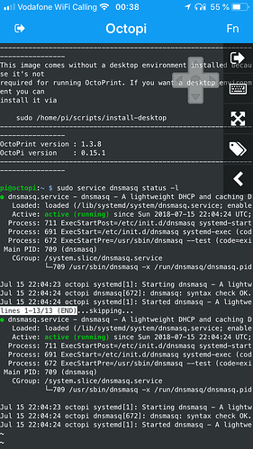

What is the output of sudo service dnsmasq status -l
That is what I got

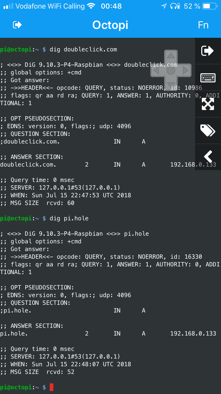

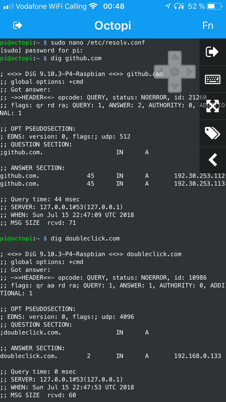

While the resolv.conf file is using localhost, what is the output of these commands?
dig github.com
dig doubleclick.com
dig pi.hole
Herr we Go

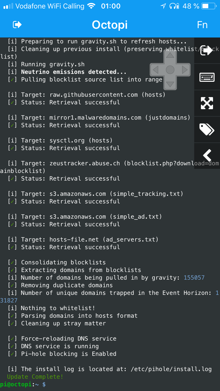

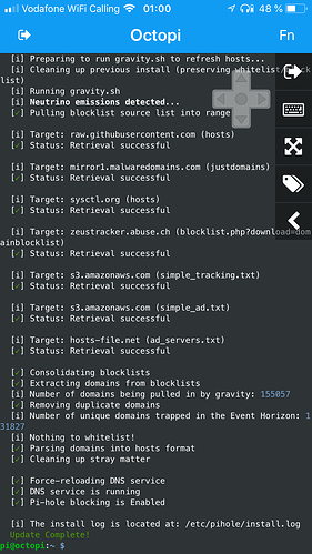

Ok, run pihole -r to repair. One of your previous uploads didn't work, so share the output of this one.
Repaired it with the same behavior as before. No web interface. This is what I got
