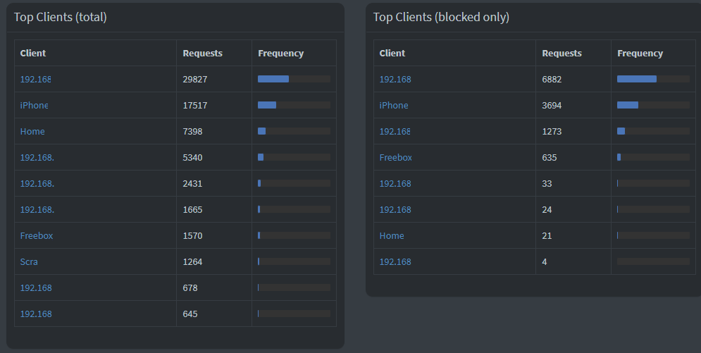

Je fais appel à la communauté aujourd'hui car je rencontre un problème d'affichage du nom des clients. au sein du dashboard.
Le DHCP est géré par pi-hole et pourtant j'ai des équipements dont je voix le noms défini au sein du DHCP et pour d'autre équipements, c'est l'adresse IP qui s'affiche (cf. PJ).
Savez-vous d'où vient le problème ou tu du moins comment le résoudre ?

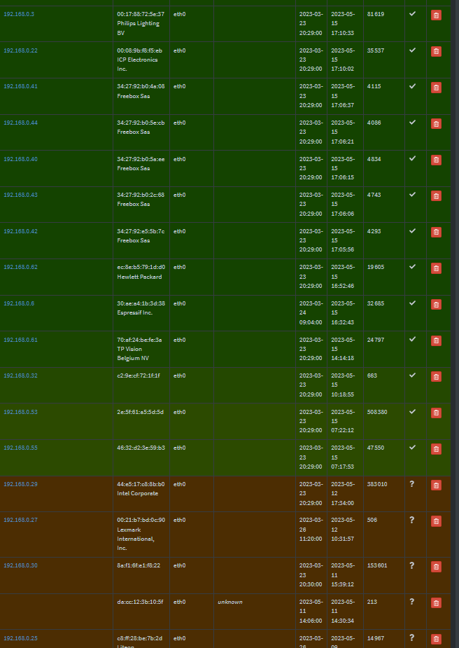

Not only. I am attaching a screenshot of the various equipment connected to my network and the names of other equipment may appear. Then A list with nothing.
I can't figure out why some names appear and not others.

It would seem that the devices in question randomise their MAC addresses.
They would use a different MAC each time they connect to your network.
You should disable MAC address randomisation on the respective devices when connecting to your home network.

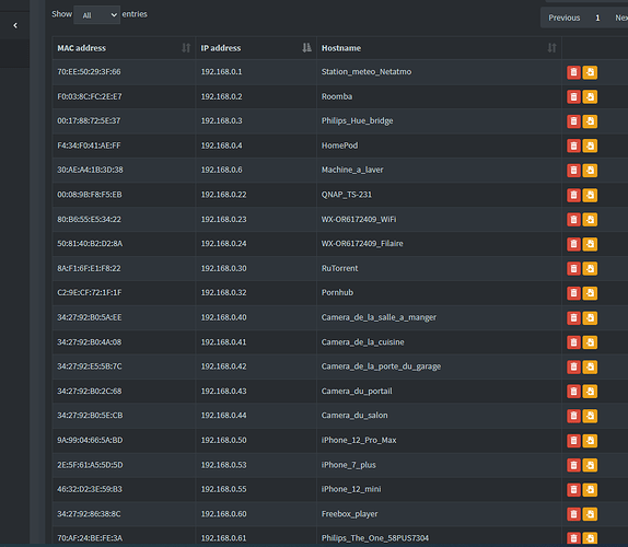

What's weird is that certain devices like my printer (192.168.0.27) or my TV (192.168.0.61) on which it is not possible to perform randomization do not appear. And some equipment with randomization appear. When others without randomization appear.
That would constitute a different issue.
A device IP that doesn't show up in Pi-hole's Query Log may either be inactive, or it is by-passing Pi-hole.
