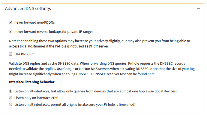

We are actually going to remove the limitation that the Pi-hole will listen only on one interface, so that this shouldn't be an issue in the future, anymore.

We are currently investigating if this option works in all cases. See
https://github.com/pi-hole/pi-hole/pull/1282
The user will be able to chose in the next release, while the default will be using local-service
