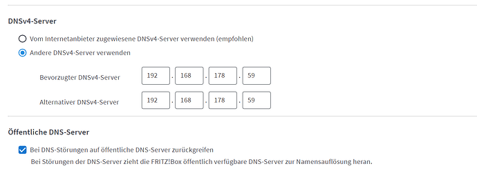

As your Pi-hole is using your FB as upstream, would your FritzBox perhaps be using Pi-hole as upstream as well?
Please share a screenshot from your router's upstream configuration from Internet/Zugangsdaten/DNS-Server.
Thanks :slight_smile:
Your FritzBox is indeed using Pi-hole as its upstream, which in turn would close a full DNS loop.
What's your intention for that?
As your previous nslookup results show that your FB is already distributing Pi-hole's IPv4 as local DNS server, your clients would use Pi-hole for DNS as soon as they acquire a fresh DHCP lease from your FB.
This would allow you to switch your FB upstream DNSv4-Servers to some public resolvers.
Sorry my fault, I set it to the default of my provider. Thank you for your help :slight_smile:
