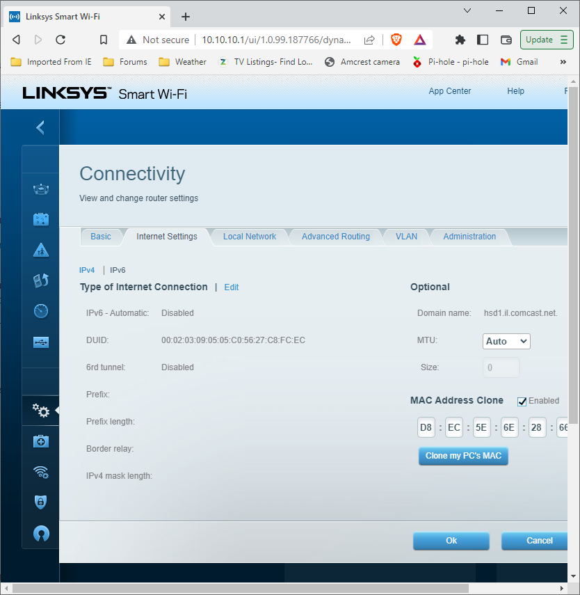

I believe that the IPv6 GUA is from the router, perhaps before I totally disabled it. Here is the router screen:
