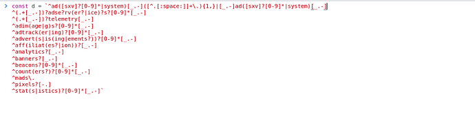

i have a alpine docker, and i didn't want to install anything on it
so i came up with this trick
basically go to the devtools and make a variable called d, that contains the list of regexes, seperated by a new-line
then you use this command
d.split`\n`.map(e=>`"${e}"`).join(' ');
it basically turn it into a one line text that is acceptable by pihole's regex.
then all you do is
right click on the result text and press on "copy string content"(chrome).
then finally you go to your console and type
docker exec pihole_pihole_1 pihole --regex YOUR_COPIED_TEXT_HERE
note that pihole_pihole_1 is my container name,
you can find yours if you enter docker ps
i hope this made your life a little bit easier
