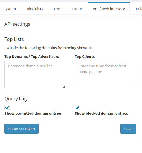

Doesn't fulfill API/Web interface - Query Log
Show permitted domain entries
Show blocked domain entries
your needs?

Are you talking about the filter options under 'Long Term Data > Query Log'?
Those allows you to filter available queries based on blocked allowed status yes, but we are talking about being able to control how much data is available for blocked vs allowed queries independently.
  • More privacy for allowed queries
  • More visibility for blocked queries
At the moment all queries get the same privacy treatment.
No, I'm talking about options for 'Query Log'
But your're right this are just toggles for visibility not privacy.

Please consider changing the title for this request, as hiding permitted/blocked queries is already possible.
The request should be to not log/store permitted requests at all, while only logging/storing blocked requests.
