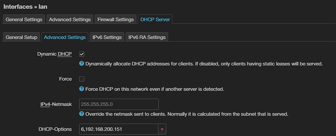

I use OpenWRT on my router, here is where I have the Pihole (Ubunutu server) defined:

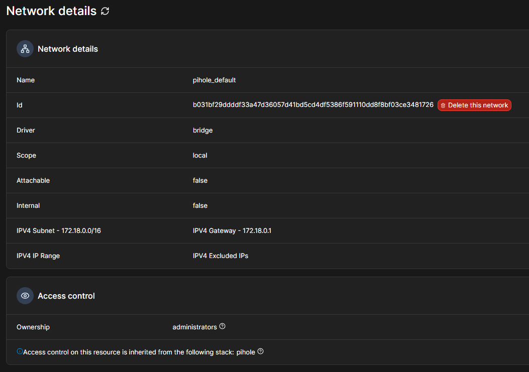

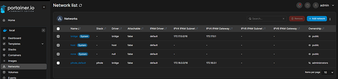

Ahh OK. I use Portainer as well, I can try it on that since I am pretty new to Docker. And actually, as I look, there is a pihole bridge already created under networks:
Actually I have been running Pi-Hole v6 Beta and systemd-resolved side by side on a Debian 12.8 system booted as Live ISO environment from an USB Stick :slight_smile:
And for Docker Containers it's always the best to use MACVLAN for your network :+1:
Ok, perfect. It looks like you'll want to use the bridge -> pihole_default and map it like 172.17.0.2:172.18.0.2 where 172.17.0.2 is the actual ip you'd connect to the pihole with, and 172.18.0.2 is the internal pihole bridge.
If there are any options in the pihole container to change it from host networking to bridge networking, that would be the way. I am assuming that your LAN is 172.17.0.1/16?
I gave the wrong advice, sorry. You'll want to create a new network and use either the IPVLAN or MACVLAN driver, and use the same subnet as your LAN. That will be the network that you use, with the mapping being 192.168.200.151:172.18.0.2
Information on which driver you'd like to use can be found here: Network drivers | Docker Docs
FYI I did find this - https://docs.pi-hole.net/docker/DHCP/?h=bridge#docker-pi-hole-with-a-bridge-networking it says not to use the out of box network bridge so I made my own. Easy enough and I named it simply "pihole"

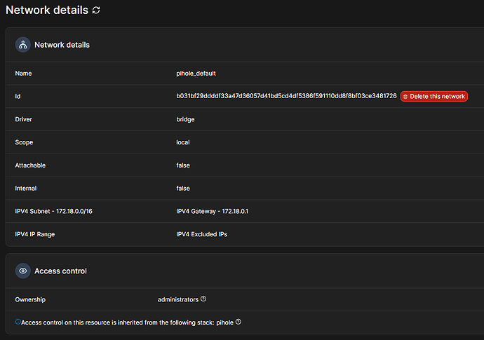

One thing I am confused about is how to map/define it in docker-compose. Is this how I would define it in the docker-compose?
   networks:
      - pihole  # Attach container to the existing bridge network
Correct.
OK thanks, I'll poke around and get back to you.
