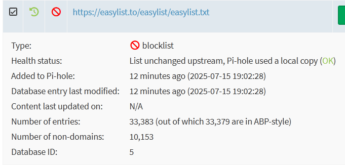

The gravity code that you linked to is not involved with the list parsing process anymore, it is all handed off to pihole-FTL at pi-hole/gravity.sh at cef7fd4b02c9ae4314e7478c0d542379bfce7f65 · pi-hole/pi-hole · GitHub
And easylist does parse down to some usable:
Including support for ABP style lists (that was in the original Pi-hole code but removed around version 4 because it was very difficult to try and figure out what the list was intending to do) meant that we only allow and recognize a single format for the domains. I'm not fully sure why ||github.com^ was seen or converted from ! github.com because we only look for that specific ||<domain>^ pattern and do not try to convert or modify any other lines.
That said, I'll check on the FTL side to see how that parsing process is handling things. It may indeed already account for the ! style comments.
Here's the parsing code and it's pretty well commented. The ABP style comment is skipped so I'm not sure how you ended up with ||github.com^ as a filter.

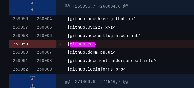

This isn't a Pi-hole issue.
The blocklist in question previously included the line:
||github.com^
Which, as I write this, was removed 17 hours ago.
Presumably by the time you downloaded the list to see if it contained github.com the correction had already been made, but your gravity hadn't been updated (because it couldn't get to github to get the new list) and was still blocking it.
