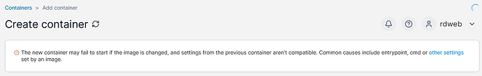

I wanted to update my pihole, but at the moment I get errors via portainer webgui.
In the past, there was no problem.
I get this error, when I recreate the container.

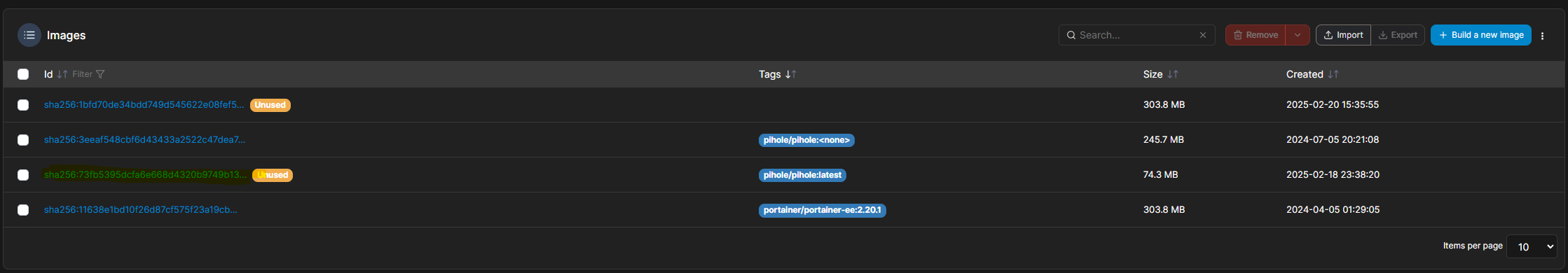

The yellow lighted image should be used, I don't know how I can fix the problem.

  • Did you create a completely new container or did you try to "Duplicate/Edit" the previous container?
  • Did you read the v6 README file? Did you applied the necessary changes to use the new environment variables?
  • Can you show the container options you are using?
When I want to add the recommended variables, I can only deploy the container as new, and then I get this error. ( I wanted to duplicate / edit)
You are trying to run a new image using the old (v5) settings.
There is no /s6-init in the new image.
Set the entrypoint as "Default":

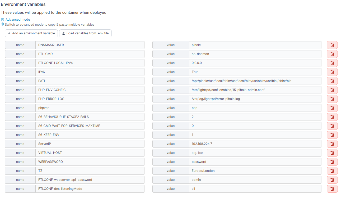

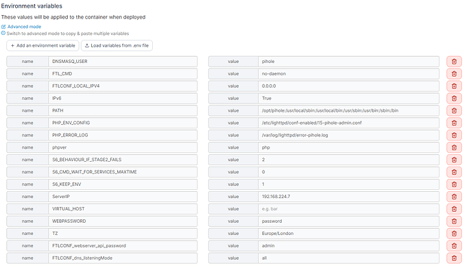

I have also troubles edit/duplicate with portainer and end up with Error500.
I added the last 3 variables and also the Entrypoint as explained above.
Yes, I am not that experienced, but maybe some path are wrong?
The Volumes maybe?
Thanks a lot.

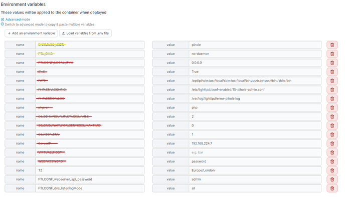

The Portainer error 500 is not very useful. There are no details to understand what is wrong, but I can suggest a few changes:
  1. You are using the wrong variables:
    I marked in red the invalid variables. I also marked in yellow the unnecessary ones (you can remove them):
    Only the last 3 are valid and needed.

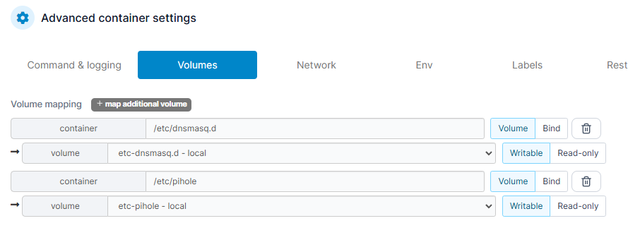

  2. volumes:
    The volumes are correct, but if you don't use custom dnsmasq files (this is an advanced option), you can remove the /etc/dnsmasq.d volume.
