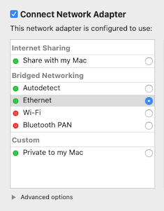

I think this is being caused by VM's network adapter setting being set to "Share with my Mac", which is the default setting if you don't change it. If so...
...this is because the VM has asked Pi-hole for an IP address and Pi-hole has supplied one, so it can see the host and its IP. But...
...the VM's network adapter IS the same as your Mac's, since it is configured to share it, so as far as the network is concerned it's just your Mac.

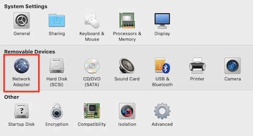

If that's correct, to fix this, edit the VM's Network Adapter settings and change it from "Share with my Mac" to "Bridged Ethernet" (or "Bridged Wi-Fi" if your Mac is connected via wifi). When it is set to bridged it means the VM appears to have its own MAC address and appears on your network directly as if it was a separate machine. You can see its MAC address in Advanced options.
My VM's are configured exactly as you suggested, in bridged mode. I tried to move from "autodetect" to the "wi-fi" but nothing changed. The AVM support told me that it is a limitation of the Fritz!Box, however I can't understand why since the router like any other device on that network should see the arp requests and populate its own table, but for some reason he can't see the mac address of the VM's that all the other devices can see.
