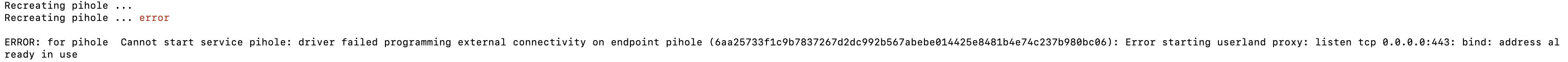

Tried this, but getting the same error for 443:
As said before, Pi-hole does not require port 443 for its operation at all.
If you are using Pi-hole's default NULL blocking mode, you can remove it from your Docker configuration.
(Pi-hole's Docker configuraton still includes port 443 for the out-dated IP blocking modes, so that HTTPS requests wouldn't starve on time-outs.)
Are you running Pi-hole in docker as well? If so, please provide the docker run line or the docker-compose yaml file.
There's no need to bind the host tcp/443 to the container, as Bucking_Horn has mentioned.
