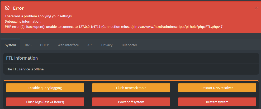

When I start the dhcp service in the pi-hole settings I get an error:
I've checked the FTL service in the container and it's running:

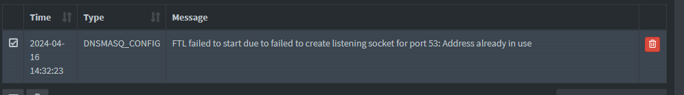

The pihole diagnosis says this:
2024-04-16 14:32:23 DNSMASQ_CONFIG FTL failed to start due to failed to create listening socket for port 53: Address already in use

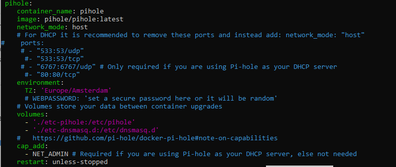

This is my composer script:
I've tried alot of things to solve this, a different src/dest port, trying to off dnsmasq which cannot be done anymore due to build in pihole v4.

https://tricorder.pi-hole.net/aF52gqWP/
You need to find out what other service is binding to port 53. What is the output of
sudo ss -tulpn sport = 53
It will be systemd-resolved causing the issue. Please see: GitHub - pi-hole/docker-pi-hole: Pi-hole in a docker container
Great it work! thank you
