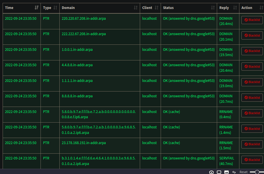

Are those PTR type queries normal?
I didn't see them before.
And it seems that the blocking is not working like it was.
Yes, these are normal. Thr first six are Pi-hole obtaining the names of your upstream DNS server, and the rest may be as well.
Pi-hole is doing this now in a loop it seems. It just does this all the time.

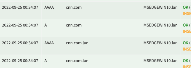

If you go to some websites and then look at your Query log, can you see your computer name appearing in the Client column? Can you see various domains showing as green and OK, and sometimes pink coloured and Blocked? As well as the PTR queries can you see A queries?
Try going to cnn.com in your browser and then come back to your Pi-hole Query page and refresh it and see whats in there. Hopefully a nice mix of green and pink entries, showing that Pi-hole is working well.

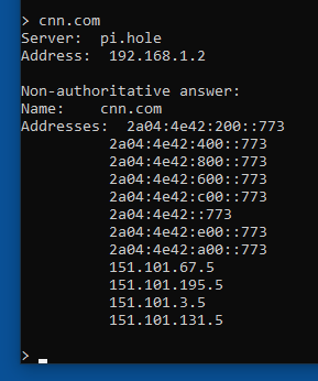

If you have a Windows computer, run a Command Prompt (search for cmd) amd type in the command nslookup. Does it show your pihole address? Eg here is mine
If it does, then type cnn.com and it should show a load of related addresses. Then pop over to your Query log in Pi-hole and refresh it, and now you should see some A records for cnn.com. Eg here is mine again

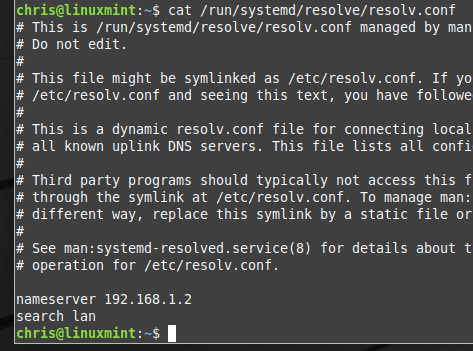

To see where the layer is going. what do you get when you view its config file by typing
cat /run/systemd/resolve/resolv.conf
Be careful on the spelling, there's an e at the end of the first resolve and not in the second. Here's what I get. You can see at the bottom next to nameserver it shows the same IP as the Windows example above – my true Pi-hole address
