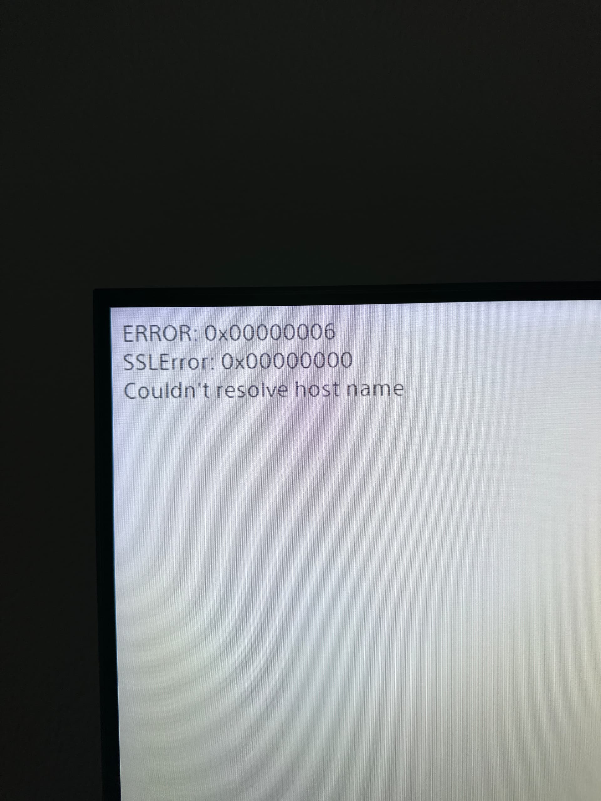

Hello, I’m frequently facing some SSL Errors with my PS5 who says me « couldn’t resolve hostname ».
Have you faced the same issue?

Your initial screenshots suggests that Pi-hole could be involved by blocking a domain your PS5 is trying to access.
When this happens again, you should investigate your Pi-hole's Query Log for your PS5's corresponding DNS queries.

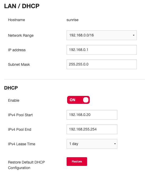

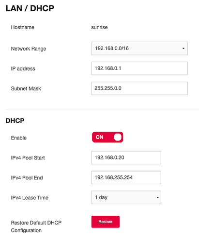

Here a screenshot of my router, I do not have much infos about this but will change the conditional forwarding to home thanks for the input!

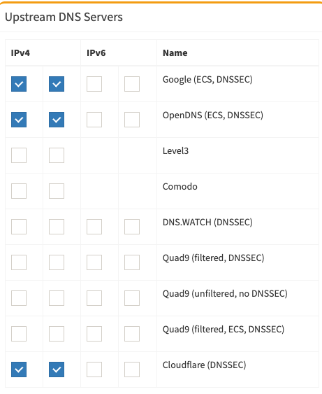

This is my config (without any upstream set by hand, do you suggest adding the Internet Provider's one?)
No, as adding another upstream would complicate the assessment.
If you have reason to believe that upstream DNS is involved, you should rather consider trying different upstream DNS resolvers one by one.
