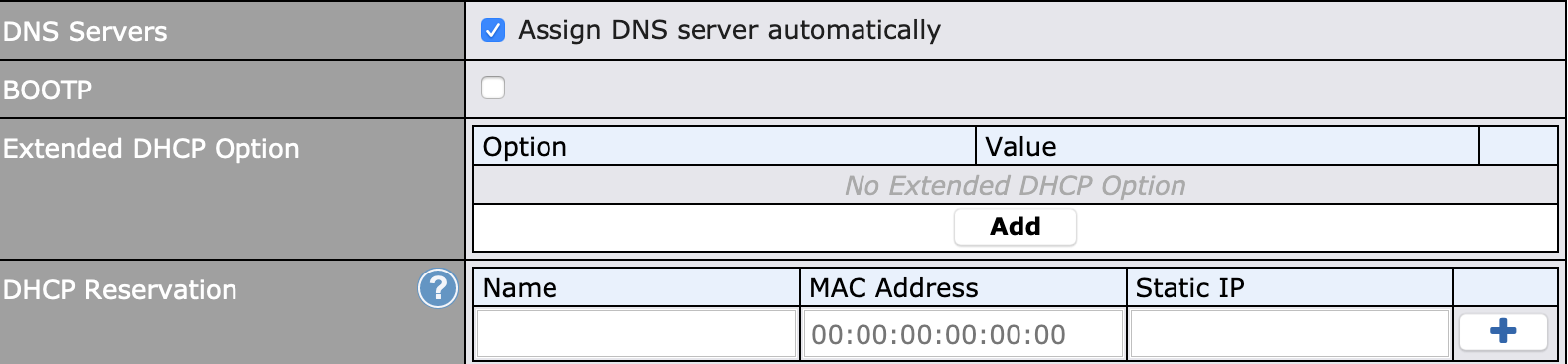

This is the lower part of the VLAN page that I'll be altering, below the IP range.
Your comment, "a) you configure your router to distribute Pi-hole as local DNS server for your VLAN (commonly a LAN or DHCP setting)" causes me to wonder if it refers to what in the above image. It's local, as far as I can discern.

Your screenshot seems to show DHCP options, but I can only speculate whether you'd either be able to supply DNS servers manually if you uncheck Assign DNS server automatically or you'd have to provide them as an Extended DHCP Option.

Thanks. Unchecking the DNS box does provide input for manual DNS choices. In retrospect, that's the image I should have posted.
