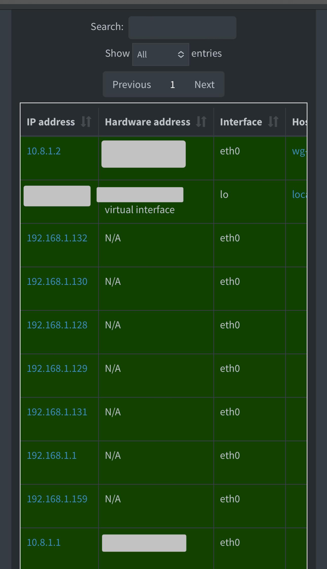

Within pihole, I can see the list of my lan devices I have (attached this).
Is there ways that i can configure within pihole or something like that, in order to allow pihole to block ads when I’m connected via vpn and disconnected but using my home wifi.

4- I recently used macvlan because I see that could be useful to connect a virtual network to the container using a real ip from my LAN. But I see pihole look the IPs even macs of my devices, but doesn’t block the ads.
