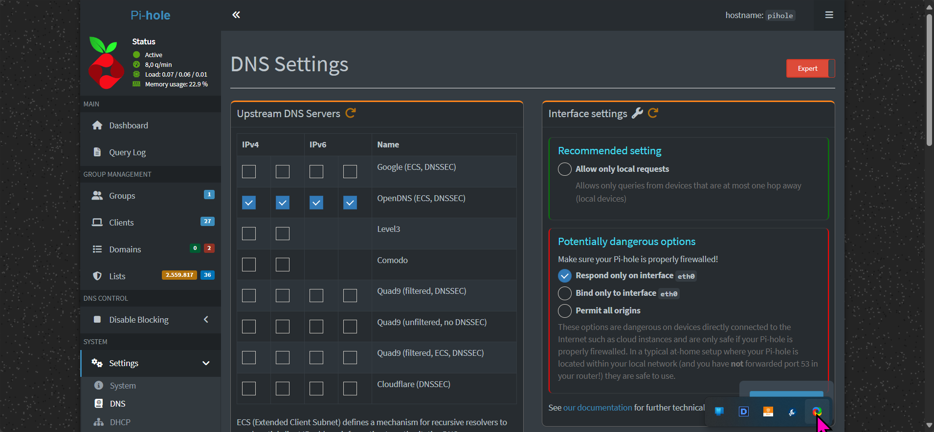

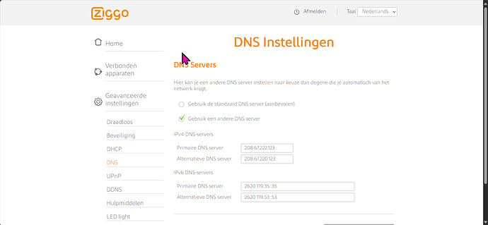

I looked into my ziggo modem and find the DNS page. It was set to "use the standard DNS (recommended)" . I tried to put in my IP of the PIHOLE (192.168.178.137) but the system refused it so I changed it into the numbers of OPENDNS.
In PIHOLE i used the same DNS of OPENDNS, and changed the setting from "allow only local" to "respond only on Eth0).
And the moment i changed that my system removed the yellow numbers after settings, indicatiing there are no problems.

Your screenshot seems to show your router's upstream DNS server configuration.
You'd need adjust its local DNS configuration, i.e. NDP/RA/RDNSS related options for IPv6 (and DHCP ones for IPv4).

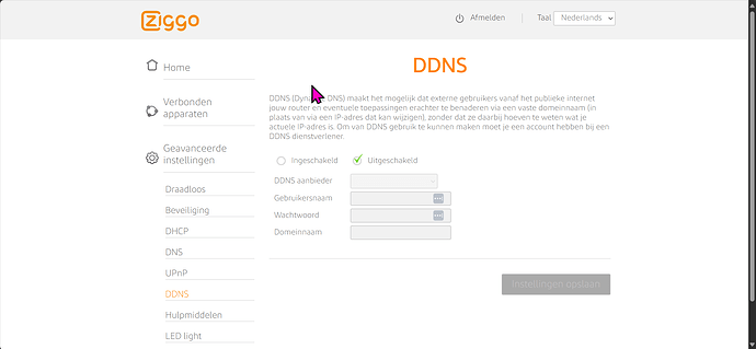

Thankyou for your answer. I dont think we can do that in our providers router.
All i got is DDNS. That is disabled. and if i enabled it , it will need password and username , so i dont think that is the right one.

This is completely unrelated. Please keep DDNS disabled.
