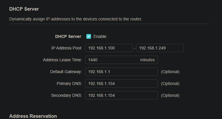

I have Pi-Hole installed on Raspberry Pi Zero 2 W and nothing else on it, it is connected to a switch via Ethernet to USB adapter which then connects to the router.
In the router configuration page I have changed the DHCP DNS to the IP address of the PiHole and the DNS settings of the router.
The current lease time is set to "Infinite" and some devices won't renew the DNS information:
     lease-time: Infinite

I have assigned static IPs through DHCP to some devices like the PiHole and the PiVPN, some cameras and another PC that runs some game servers. The rest of the devices get a 24 hour lease.

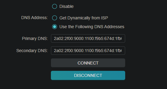

I have looked through the router settings and I can assign custom ipv6 dns so I took the ipv6 address of the pihole (ifconfig) and put it in the router settings but it doesn't seem to work.

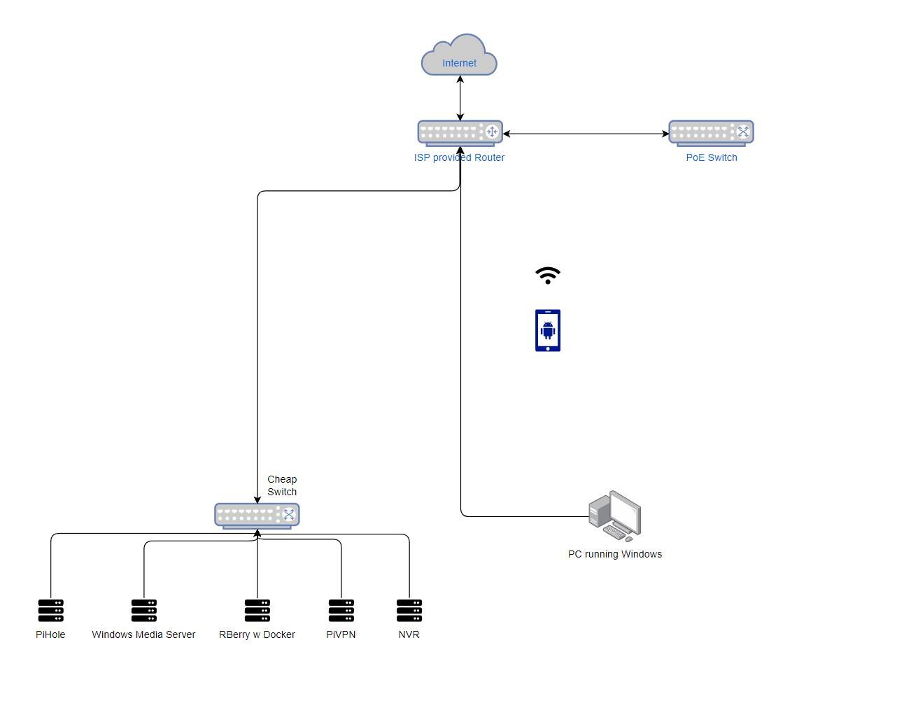

I have made a network diagram of my setup, maybe there's a problem how everything is setup.

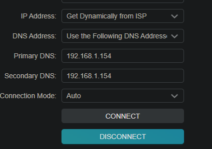

Regarding the DNS settings in the router, I have changed them to the IP address of the PiHole, under Internet (where it connects via PPPoE) and DHCP server.
I have also updated the address under IPv6 to use the IPv6 address of the PiHole.
What I did notice is that the router sometimes tends to modify the DNS IP address to the ISP provided ones without modifying from "Use the Following DNS Addresses" to "Get Dynamically from ISP" option.
Might it have some hard-coded DNS servers inside it since it runs custom firmware from my ISP?

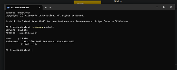

putting the same IP on the secondary DNS is not necessary. What's the results of the nslookup pi.hole command. I know you mentioned custom FW, but have you look at this guide How to use Pi-Hole DNS Server on TP-Link routers
