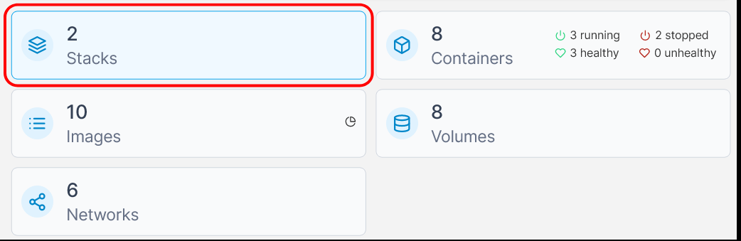

If you want to try one more time using Portainer, my suggestion is:
Thx again for your time and help.

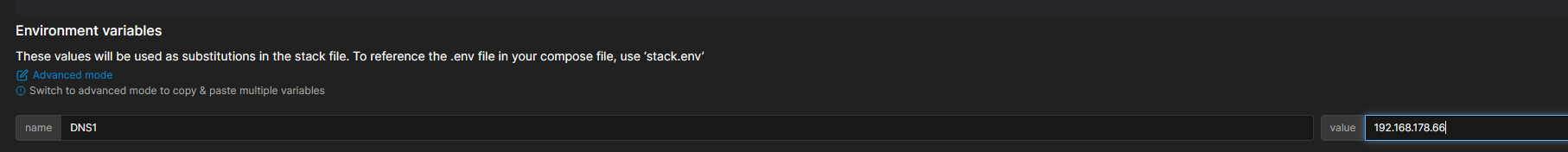

I want to set the IP 192.168.178.65 out of my mcvlan as my IP adress. I created the macvlan already in Portainer. COuld you please help me out, to add this to my File?

The next idea I have is to setup unbound (192.168.178.66) as the DNS1 in the deployment, that I don't have to change it afterwards. I do add this like this?

      PIHOLE_DNS_: '192.168.178.66'  # set your upstream DNS servers
I'm using PIHOLE_DNS_ here, because DNS1 and DNS2 were deprecated a long time ago.
