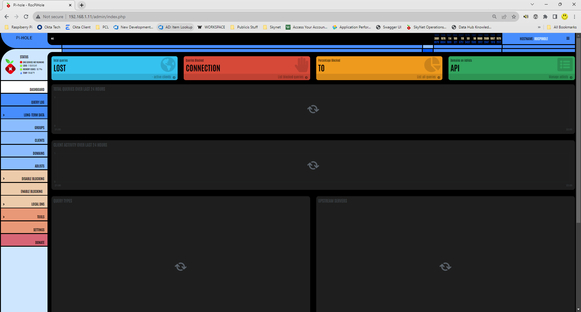

DNS resolution does not consistently work on my pihole server. It was working fine and without change, it stopped working. Now it is mysteriously working again after some time.
Alsothe pihole interface says that it cannot reach to FTL api. It stated this for a couple hours then started finding the FTL api.

Your debug log shows that Pi-hole has recently been receiving queries from network clients and blocking or forwarding them correctly.
What is the nature of the failure? Pi-hole does not receive the queries from the clients? Pi-hole receives the queries but the upstream DNS server is not providing a response?
Please post a screen capture of your dashboard showing the query graphs at the top - in this forum you can paste clipboard contents directly into a reply, or upload a file with the image.
What troubleshooting have you done? Have you changed upstream DNS servers used by Pi-hole?
You have blocking disabled on Pi-hole. Was this intentional (part of your troubleshooting)?

I have 2 pihole servers and have my network configured to use both. I have two servers in the event that one goes down.
I rebooted several times to unstick it with the same result.
In this past outage two observations:
  1. I could get into the UI, but the UI would not render any data. A message appeared in the Total Queries, Queries Blocked, Percentage Blocked, and Domains on Adlists boxes in the UI stating that the website could not connect to the FTL.
Doing a pihole status reported that everything including FTL was up and listening.
  1. I could not dig to google.com, i could not do a ping to google.com, i could not do an nslookup to google.com. I could ping to outside IP addresses.
  2. I compared the settings files between both of my pihole servers to confirm they are the same.
Right after I ran the diagnostics to completed this discord post, this pihole started working. FTL was accessible and also DNS resolution started working. I wonder if the diagnostics run unstuck it.
The is the second time I had this issue with this pihole.

Ok, i just noticed that FTL cannot be accessed by the UI again.

[    6.605986] systemd[1]: Started Journal Service.
[    6.658532] systemd-journald[372]: Received client request to flush runtime journal.
[    6.899637] mmc_host mmc0: Timeout sending command (cmd 0x202000 arg 0x0 status 0x80202000)
[    7.928836] mc: Linux media interface: v0.10
[    7.940219] lima ff300000.gpu: Looking up mali-supply from device tree
[    7.940787] lima ff300000.gpu: gp - mali450 version major 0 minor 0
[    7.940857] lima ff300000.gpu: pp0 - mali450 version major 0 minor 0
[    7.940920] lima ff300000.gpu: pp1 - mali450 version major 0 minor 0
[    7.940954] lima ff300000.gpu: l2 cache 8K, 4-way, 64byte cache line, 128bit external bus
[    7.940965] lima ff300000.gpu: l2 cache 64K, 4-way, 64byte cache line, 128bit external bus
[    7.956945] lima ff300000.gpu: bus rate = 163840000
[    7.956972] lima ff300000.gpu: mod rate = 163840000
[    7.957066] lima ff300000.gpu: Looking up mali-supply from device tree
[    7.957104] vdd_logic: could not add device link ff300000.gpu: -EEXIST
[    7.958709] [drm] Initialized lima 1.1.0 20191231 for ff300000.gpu on minor 1
[    7.984331] rk3328-codec ff410000.codec: spk_depop_time use default value.
[    7.990524] videodev: Linux video capture interface: v2.00
[    8.017913] rockchip-saradc ff280000.adc: Looking up vref-supply from device tree
[    8.017936] rockchip-saradc ff280000.adc: Looking up vref-supply property in node /adc@ff280000 failed
[    8.017966] rockchip-saradc ff280000.adc: supply vref not found, using dummy regulator
[    8.019035] rockchip-saradc: probe of ff280000.adc failed with error -22
[    8.104815] rockchip_vdec: module is from the staging directory, the quality is unknown, you have been warned.
[    8.126444] rkvdec ff360000.video-codec: Adding to iommu group 3
[    8.126483] iommu: Failed to allocate default IOMMU domain of type 4 for group (null) - Falling back to IOMMU_DOMAIN_DMA
[    8.127887] hantro-vpu ff350000.video-codec: Adding to iommu group 2
[    8.127962] iommu: Failed to allocate default IOMMU domain of type 4 for group (null) - Falling back to IOMMU_DOMAIN_DMA
[    8.148442] hantro-vpu ff350000.video-codec: registered rockchip,rk3328-vpu-dec as /dev/video0
[    8.186006] Registered IR keymap rc-empty
[    8.186117] rc rc0: gpio_ir_recv as /devices/platform/ir-receiver/rc/rc0
[    8.186943] rc rc0: lirc_dev: driver gpio_ir_recv registered at minor = 0, raw IR receiver, no transmitter
[    8.187167] input: gpio_ir_recv as /devices/platform/ir-receiver/rc/rc0/input0
[    8.283938] input: rk805 pwrkey as /devices/platform/ff160000.i2c/i2c-1/1-0018/rk805-pwrkey/input/input1
[    9.371835] 8021q: 802.1Q VLAN Support v1.8
[    9.530631] cfg80211: Loading compiled-in X.509 certificates for regulatory database
[    9.584533] cfg80211: Loaded X.509 cert 'sforshee: 00b28ddf47aef9cea7'
[    9.618448] cfg80211: loaded regulatory.db is malformed or signature is missing/invalid
[    9.625991] Adding 102396k swap on /var/swap.  Priority:-2 extents:1 across:102396k FS
[    9.724601] rk_gmac-dwmac ff540000.ethernet eth0: Register MEM_TYPE_PAGE_POOL RxQ-0
[    9.727031] rk_gmac-dwmac ff540000.ethernet eth0: PHY [stmmac-0:00] driver [RTL8211E Gigabit Ethernet] (irq=POLL)
[    9.727076] rk_gmac-dwmac ff540000.ethernet eth0: No Safety Features support found
[    9.727091] rk_gmac-dwmac ff540000.ethernet eth0: PTP not supported by HW
[    9.747621] rk_gmac-dwmac ff540000.ethernet eth0: configuring for phy/rgmii link mode
[    9.900431] openvswitch: Open vSwitch switching datapath
[   13.855717] IPv6: ADDRCONF(NETDEV_CHANGE): eth0: link becomes ready
[   13.855877] rk_gmac-dwmac ff540000.ethernet eth0: Link is Up - 1Gbps/Full - flow control rx/tx
[   15.277151] ICMPv6: process `dhcpcd' is using deprecated sysctl (syscall) net.ipv6.neigh.eth0.retrans_time - use net.ipv6.neigh.eth0.retrans_time_ms instead
roc@RocPiHole:~ $
There is so much wrong to inspect/fix, that I'm inclined to say start over fresh again.
But this time in stages so first get Pi-hole up and test for a while before installing Unbound.
If thats working ok for a period, install the others like openvswitch etc.
But maybe someone else has a brilliant idea?
This will temporarily reset the nameserver on the Pi to bypass Pi-Hole DNS.
sudo nano /etc/resolv.conf
Edit the nameserver line to nameserver 9.9.9.9 or your preferred third party DNS service, save and exit
Run
and upload the debug log.
Here is the latest debug log after making the temporary nameserver change to 9.9.9.9
https://tricorder.pi-hole.net/z5xQLVOg/
Thank you for your help.
I reimaged my ROC-RK3328-CC running Debian Bullseye and then installed PiHole again. Then after I used this documentation to install Unbound: unbound - Pi-hole documentation
I got the same same results, so I am concluding that the Debian Bullseye OS port for the ROC is at fault.
I reimaged my ROC-RK3328-CC running Ubuntu and then installed PiHole then Unbound. This has been successful. I have had no issues whatsoever with Unbound or with PiHole.
Since everything is working now, I am in good shape. I would recommend to anyone running the ROC-RO3328-CC to use Ubuntu instead of Debian Bullseye when trying to run PiHole and Unbound.
