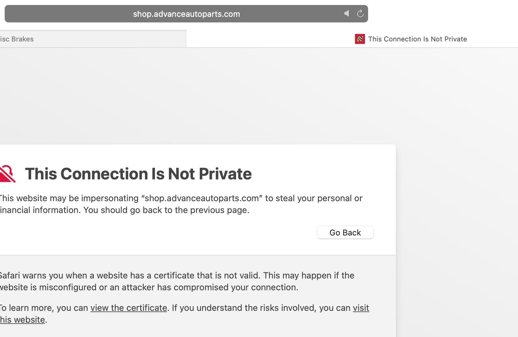

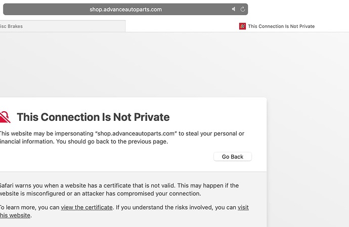

when trying to go to amazon.com, I get an error in any browser saying it can't find the address. When I look in the log, I see:
This is intermittent...sometimes it resolves correctly, sometimes it doesn't.

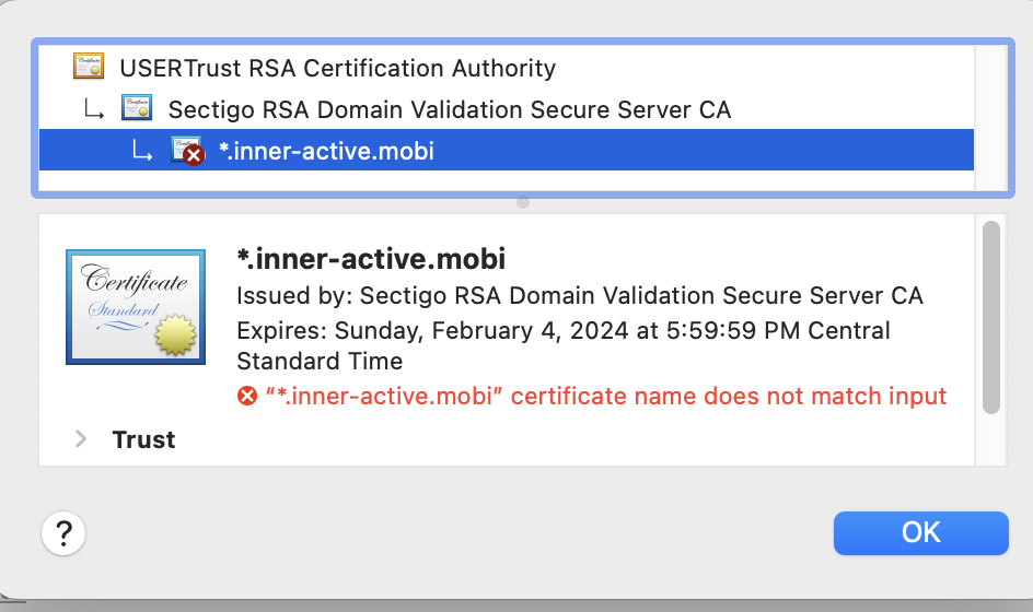

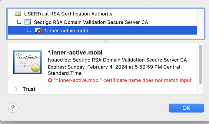

Also, I get this with certificate errors...as you can see it resolves to the wrong certificate. If I keep refreshing, it eventually works
