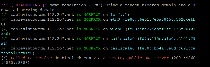

When I try to debug this is the error that I have. I tried changing the resolve.conf, but tailscale writes over it. Maybe this isn’t even a pihole issue; it could be a tailscale issue.
[✗] DNS resolution is currently unavailable
  [i] Waiting up to 120 seconds for DNS resolution
This is what I get from GUI
Unfortunately, I can’t get a token because it won’t upload the file. I’ve attached some screenshots from some portions of the debug I run

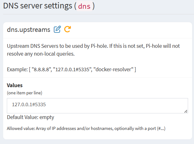

I appreciate your help. I saw what you were saying when I ran tailscale dns status where it told me to run sudo tailscale set --accept-dns=false . So I ran it also. It didn’t say whether it went through or not, so I assume that it did. I put what my upsteam dns is set at. Is that correct? Again thank you!

Id recommend having in /etc/resolv.conf not exclusively servers from the local machine(this would also include unbound) and at least one trusted public resolver. This will make troubleshooting easier when something goes wrong with the local DNS server. You can just add 1.1.1.1 or a different trusted public resolver as a fallback option, on a newline in /etc/resolv.conf.
Like this
nameserver 127.0.0.1
nameserver 1.1.1.1
