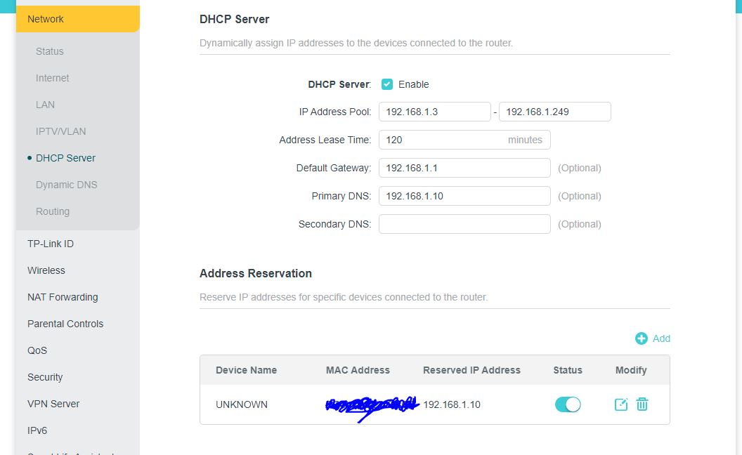

What i'm trying to do is the following:
make my router's DNS point to pihole, (which in fact is running) by setting the DNS in DHCP to my pihole's IP address.
Given in this picture:
Now, this doesn't do anything i'd like it to. The devices are not using it as my DNS server and I can verify this by looking at the pihole logs, which keep clear except for the device itself.

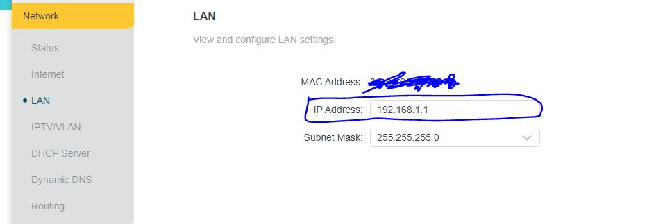

Now there is a setting in the router within Internet which also gives a DNS server and I can edit this, but once I do, the LAN IP changes to 192.168.0.1 and the network is no longer running as it should because the DNS is pointing to 192.168.1.10. when, in turn, i try to change this IP address to 192.168.0.10 for instance, the LAN IP changes back to 192.168.1.1. And this goes on.

Setting Pi-hole as "Primary DNS" in the DHCP Server tab sounds like a good approach. Did you dis/reconnect your clients to the network after you made changes in the DHCP settings? Otherwise they won't pick up changes...

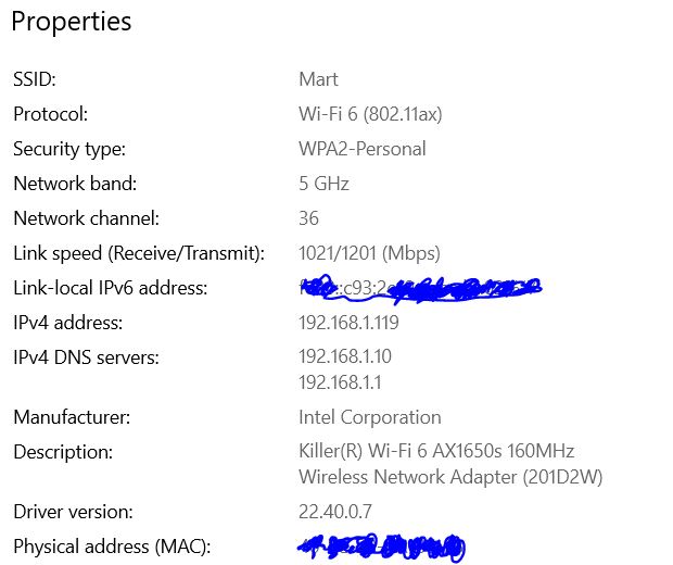

I also toke a look at my wifi properties of my laptop where I found out that indeed my laptop is using the PI as DNS:

Your router advertises itself and Pi-hole via DHCP as DNS server. You should configure to only advertise your Pi-hole, otherwise your clients will bypass Pi-hole.

This depends on your router model. Judging from the screenshots above, it looks like you only entered "Primary DNS". You can try to enter Pi-holes IP as "Secondary DNS" as well and see if it suppresses the router's own IP as DNS server.
If not, you could disable the router's DHCP server and use Pi-hole's built-in DHCP server.
Thanks, i will try to do the first. The 2nd is what i'd like most but that's where issues start to happen as described in the top post.
