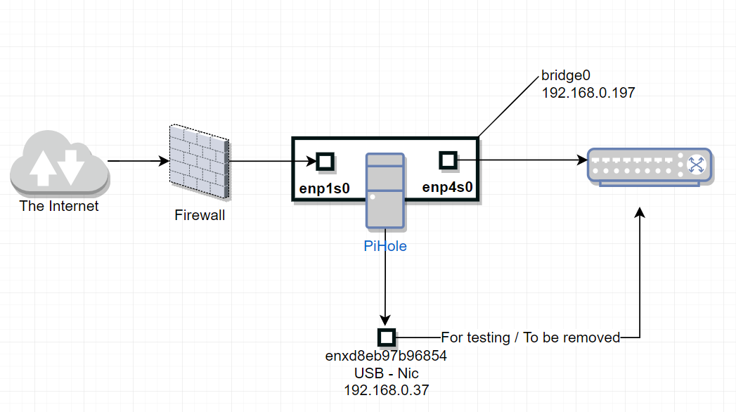

I would like to have PiHole run on a box that is in bridged mode or less technically as a bump in the wire. The goal would be to use PiHole as DNS, DHCP, and vnstat to monitor network usage.
However I keep running into two snags.
  1. When I unplug my 3rd nic all DNS fails on box and throughout the rest of the network.
    The box has the following setup:
bridge0 (created by me with a static address of 192.168.0.197)
enp1s0 (onboard nic)
enp4s0 (realtek PCI nic)
enxd8eb97b96854 (USB3 Nic used for setup)

My setup looks like below:
Internet > Firewall > PiHole (bridge0 (enp1s0 > enp4s0)) + enxd8eb97b96854 > Core switch

Here is a rough diagram.
provided the ipv4 address is set to 192.168.0.197 and the gateways is set properly you should not lose anything when you disconnect the usb adaptor. this assumes that your routing and network is set up properly
Ah, you pointed me in the right direction. Carelessly I had overlooked the fact the box was trying to use the gateway on the USB nic and none was assigned to the bridge.
-duh-
thanks for the tip!
