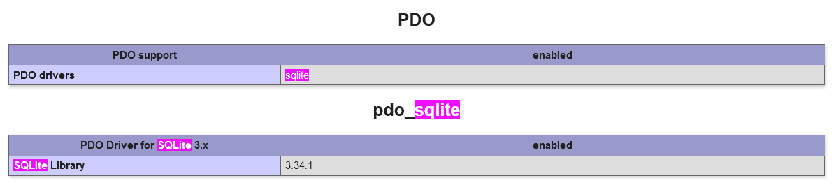

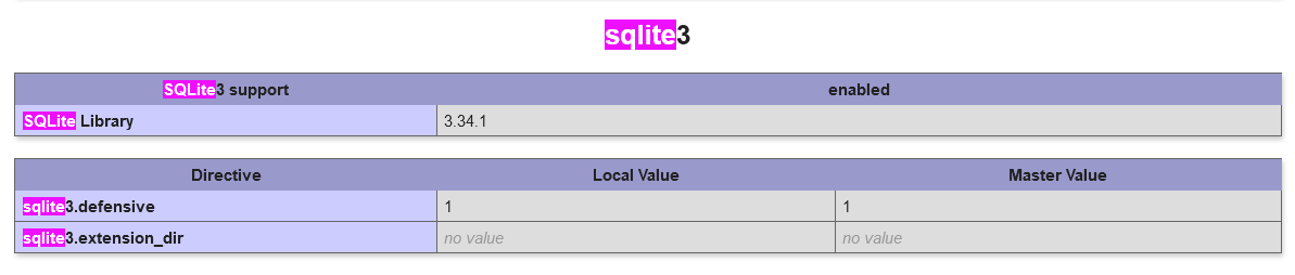

To verify, you need to execute this on the command line (in your Pi-hole machine):
echo "<?php phpinfo(); ?>" > /var/www/html/admin/info.php
This will create a new file.
Now, access the file via browser: http://pi.hole/admin/info.php (change port if needed)
Search for these sections (ctype, PDO and sqlite3):
