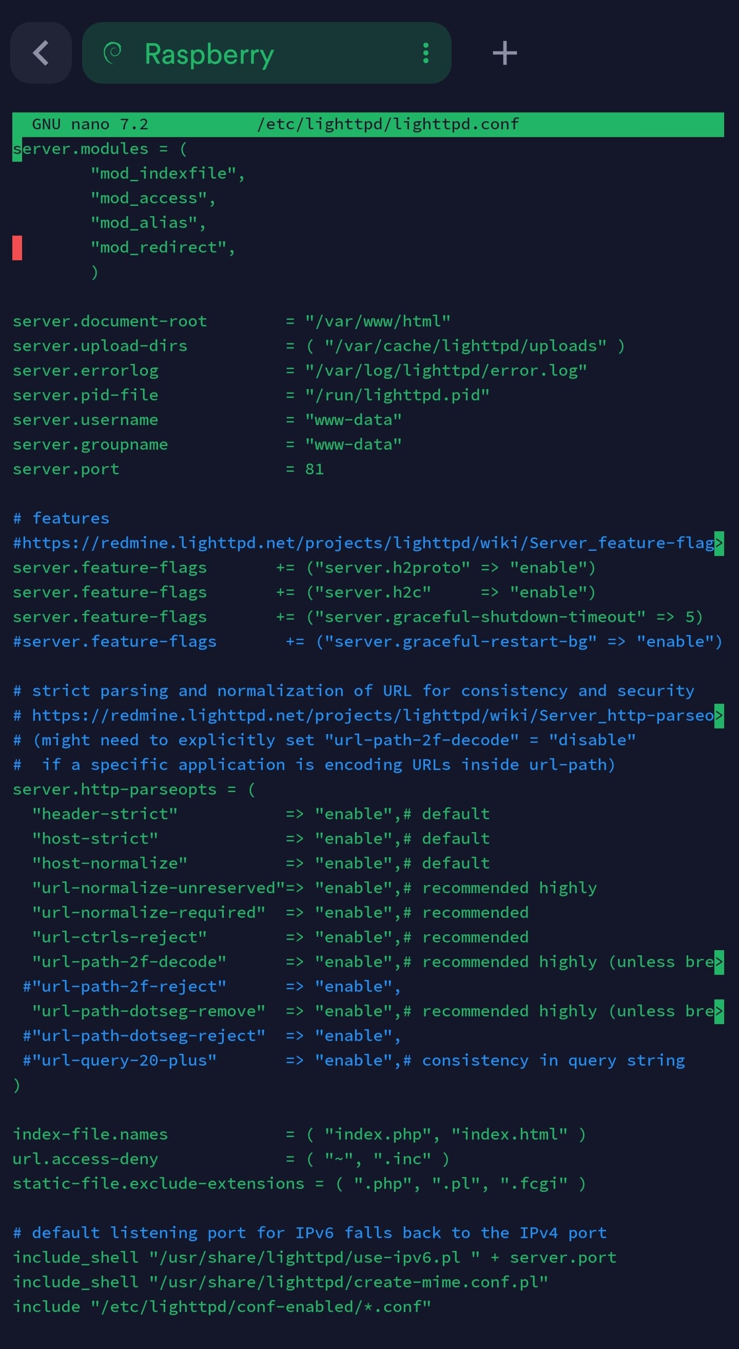

Hi everyone, I'm trying to get Pihole running on my Raspberry Pi 3b. Everything's updated so far. I'm running FlightRadar24 in parallel, which isn't causing any problems, but I need to change the access port for Pihole (81). I did this using sudo nano /etc/lighttpd/lighttpd.conf (see attached image). Unfortunately, it doesn't seem to be working.
As soon as I try to go to the link: http://raspberry-ip/admin/login, I get: 404 not found.

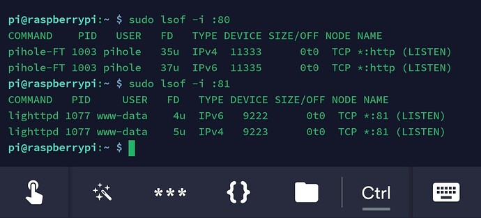

Your debug log shows you are running lighttdp on port 81 and Pi-hole v6 on port 80:
[✓] tcp:0.0.0.0:80 is in use by pihole-FTL
    tcp:0.0.0.0:81 is in use by lighttpd
What do you see when you try http://192.168.178.75/admin ?
