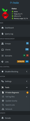

I can get web interface on http://mylocalip:8080/admin/
but interface looks different

The screenshot you provided shows the correct V6 web interface.
Yes, you can change the settings there.
