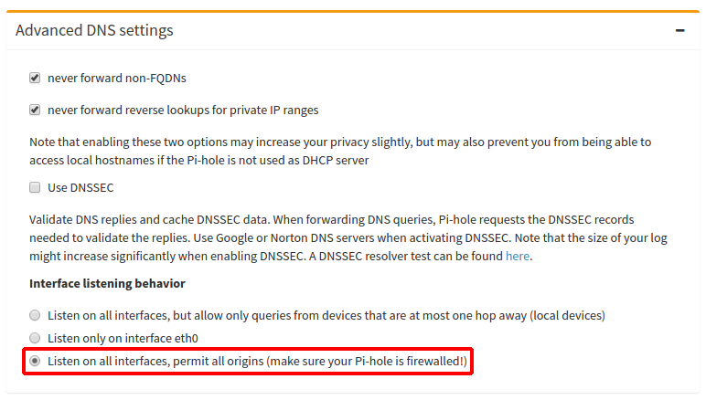

The easy way of fixing this (at least as you are located behind a router e.g. at home) is to change the listening behavior on the settings page of Pi-hole:
Thanks @DL6ER. This is the easiest way to do it. Worked for me.
Can anyone expain how to fix this issue. If i set listen on all interfaces OpenVPN works, if i set listen only on interface eth0 i can connect with OpenVPN but routing not working with Pihole. I think my iptables are OK but it have something to do with the eth0 and tun0 interfaces that need to be configured somewhere. Hope that anyone can help to provide a solution. Thx!
Edit: Is it OK to just add pihole_Interface=tun0 to the setupVars.conf file?
What's the issue with listen on all interfaces?
I have my setup with that option.
If I'm not mistaken tun0 will only filter if you are connected to the VPN. For local+remote resolution you must have listen on all interfaces. Your pie should be behind a gateway firewall which makes the Pi's iptables unimportant.
Hope this helps.

Thanks for the input. Thought that listen on all interfaces is less secure than listen to eth0 only. Anyway it works like this so i'm just leave it like that.
