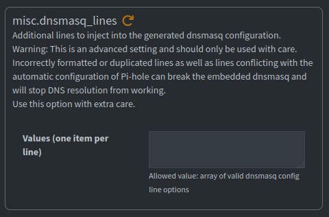

development-v6 offers you to specify custom dnsmasq config lines via the web interface without the need to mess around with any auxiliary config files. Furthermore, such lines are backed up (and also restored) through Pi-hole's teleporter and they are even checked before being applied to avoid killing your DNS/DHCP server due to a typo somewhere in the config.
