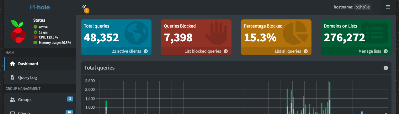

Opening pages shouldn't take minutes. And loading stats on the dashboard shouldn't take longer than a few seconds.
  • Now I click a page to load and I'm waiting minutes.
  • My CPU is over 100% all the time and over 200% when trying to do anything (even when nothing is loading).
  • The dashboard takes ages to load any stats.

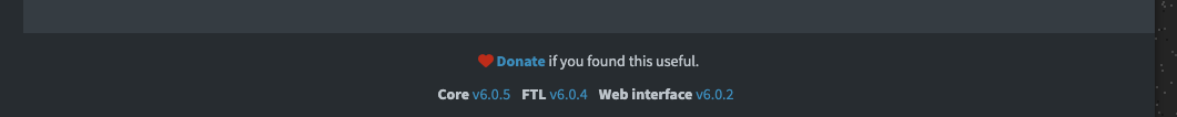

I've run the first 2 commands had to run the following for them to work:
sudo pihole checkout ftl v6.0.4
sudo pihole checkout web v6.0.2
The second command didn't work and reported the following:
  [i] Requested branch "v6.0.2" is not available

Looks like I'm already running the v6.0.2 webui:
And the CPU is still sticking above 100%:

Did you run
As we try to isolate the component that may have introduced your issue, it would also be possible that downgrading core to v6.0.4 has had an impact?
You can switch between specific component versions, e.g.
pihole checkout core v6.0.5
pihole checkout core v6.0.4
When done, you should switch back to
pihole checkout core master
You can also do so for all components (web, core, ftl) at once:
pihole checkout master
An update, my current configuration is as follows:
Screenshot 2025-03-18 at 09.47.47
  • When I browse using http, everything seems to be running fine, no issues and the system looks like it's snappy and responsive.
  • When I use https, i see the CPU spike and the interface get sluggish; it's not as sluggish as it was after the initial upgrade but noticeably so.

I just tried checking out the v6.0.4 core branch and it looks like it didn't work:
pi@pihole:~ $ sudo pihole checkout core v6.0.4
A quick update. I've run the following command:
sudo pihole checkout master
and realised I'm running the master branch already for each component.
It looks to me like running the WebUI through https is what was causing my pi to be unresponsive and sluggish. Whenever I do anything on the pi it's cpu spikes, it looks like i'll to live with that for the moment.
