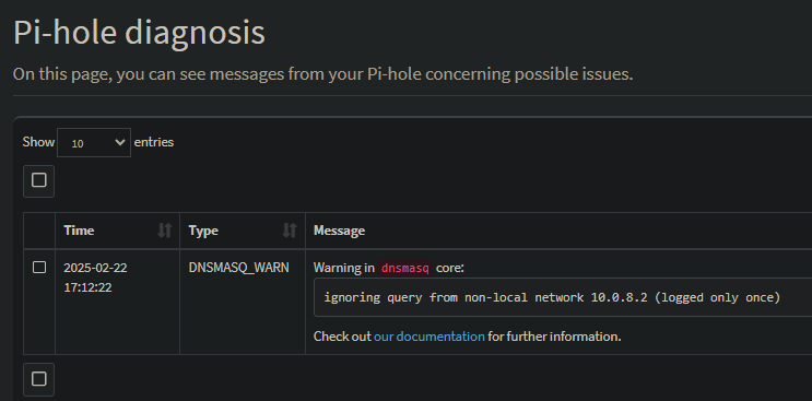

Additionally, now I'm seeing this:
which I didn't have before the ground-up rebuild

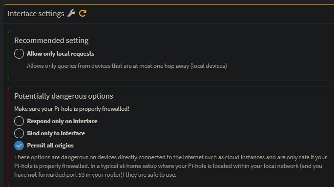

So I looked in here:
And sure enough, set to local only
So I tried Permit all origins:
and the diagnosis message goes away:
But I still do not have dns resolution on the handset when connected to OpenVPN on my PFSense box.

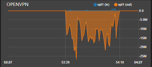

Just noticed a load of outstanding updates on the same phone that won't get DNS resolution on VPN and tapped update all, and, well, they started updating, while on VPN.
DNS requests are streaming in, and being answered, for that VPN client:
Yet that same device still won't resolve basic msn.com, google.com, yahoo.com, cloudflare.com addresses.
