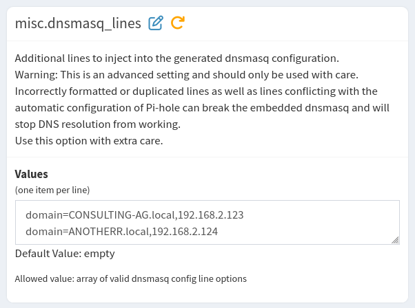

Each line should be surrounded by double quotes, and lines need to be separated by a comma eg:
dnsmasq_lines = [
"domain=CONSULTING-AG.local,192.168.2.123",
"domain=ANOTHERR.local,192.168.2.124"
] ### CHANGED, default = []
Alternatively they can be added in the web ui, in settings -> expert -> all settings -> miscellaneous -> dnsmasq.lines. If added here they don't need the additional formatting.
Thank you for this. I prefer using the UI to possibly mucking up the .toml file.
@robgill, and one more clarification question: the IP address in this line should be the device's IP address, as in the laptop that is causing this error to appear?
Yep, the ip of the device that you want the domain pointed to.
