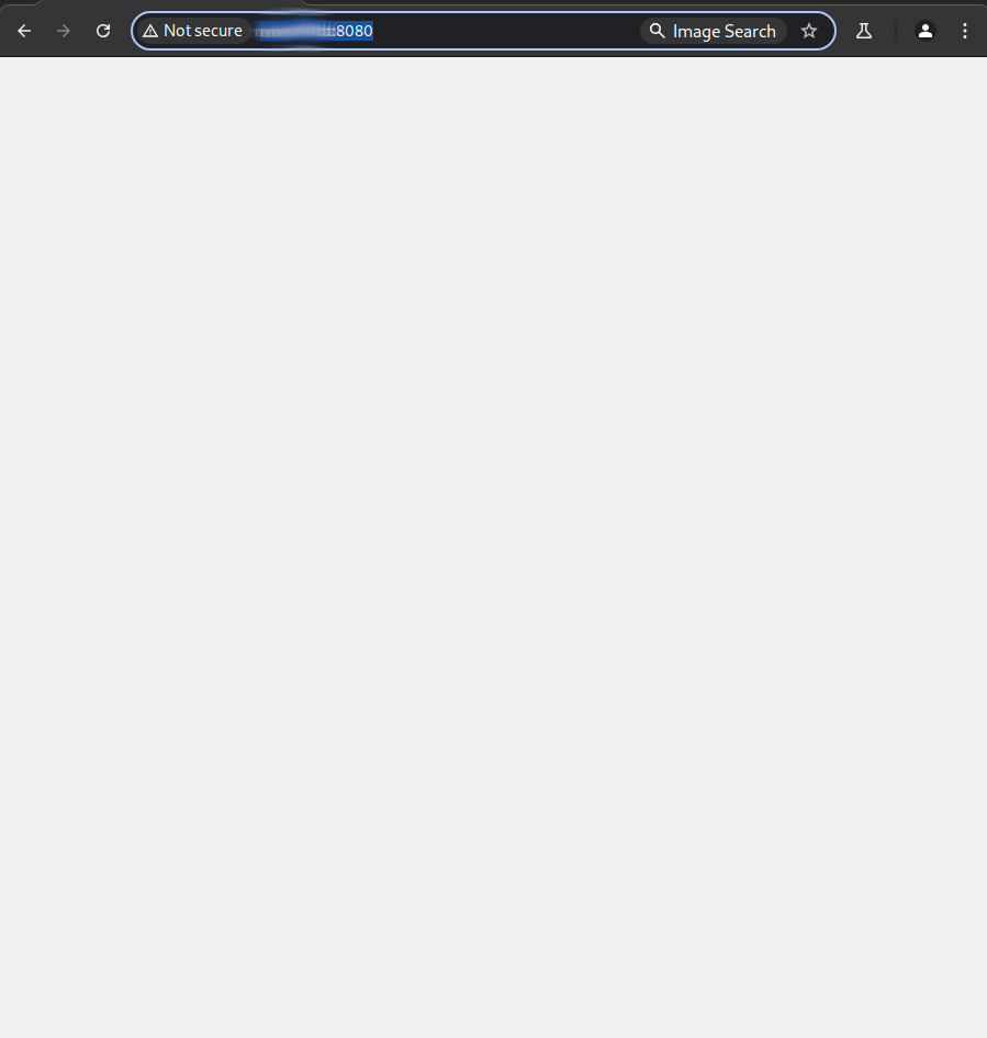

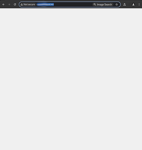

So I should be able to simply go to http://hostname:8080. Unfortunately, nothing is rendered. Any ideas?
Never mind. Stupid me did not include the /admin at the end of the URL above. Doh!
