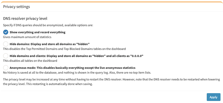

Query log shows nothing. But the dashboard shows some queries over last 24 hours. If I click on one of them, it shows me nothing.
ah, good to know. because I don't understand unbound in it's depth.
I see the problem. Your privacy level is set to Anonymous mode. Go to Settings > Privacy and choose the top option to enable the normal Query Log.
Then run the nslookup tests again and confirm they appear in the Query Log. You'll see other things in there too from your other clients.

:smiley: yesss! thanks! I forgot that as I activated the logging.
now I see the blocking of flurry and also the blocking of facebook, according to the blocking list I added.
